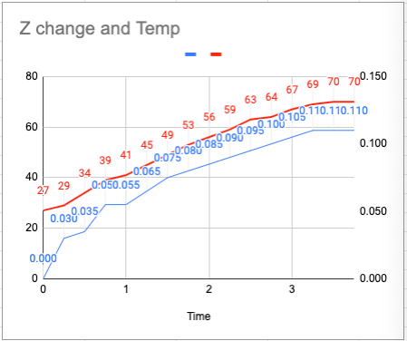

Here’s a plot of Z offset vs Temperature. The x axis is minutes.
I positioned the dial indicator in the middle of the bed.
Temp VS Z
The M851 reading is Z1.00
This was me setting the temperature to 65 and then running auto, I thought it was holding temperature as Luban was showing 60. Actually it was dropping but it didn’t update the temp display until auto calibration was completed.
Can I execute auto-calibration via the command line and have it hold temperature?
I think as soon as you do a calibrate either manual or auto it shuts off the heat.
This has been my experience as well.

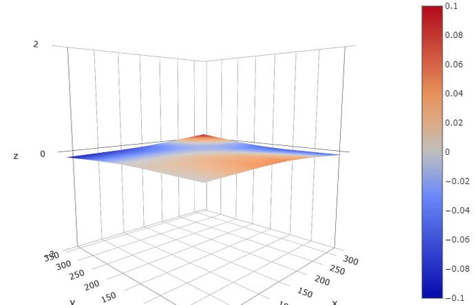

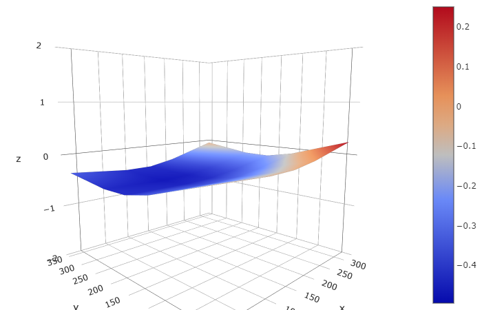

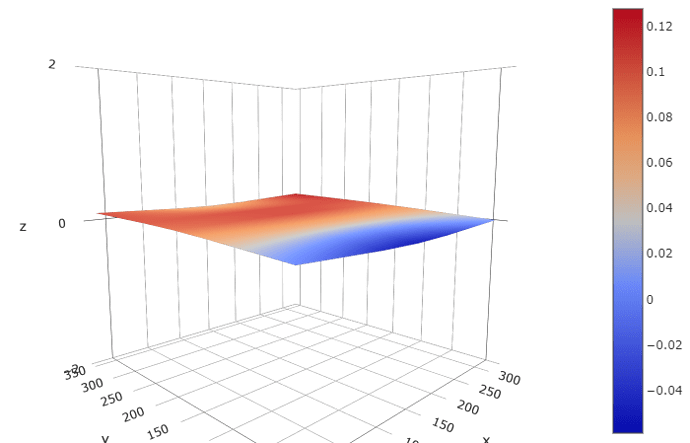

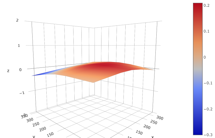

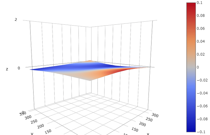

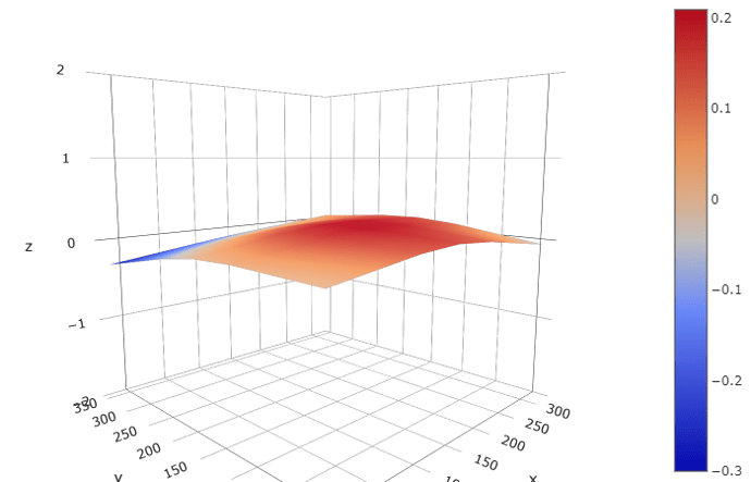

Well most of my Sunday was spent doing this. Manual leveling and a trick I thought up after getting frustrated with the flatness of my bed or the lack there of. Also did an auto calibration after I achieved a flat bed the manual way but the lack of being able to probe the bed at temperature and using only a nine point mesh really hinders the process.On the latest v1.7.0 firmware as well.
First pic above is stock and my process continued until I reached flatness
This is an automatic level after the manual level was flat and just as it would be performed (cold bed).
And this is an auto level after manually heating the bed to 70C and then running a level.

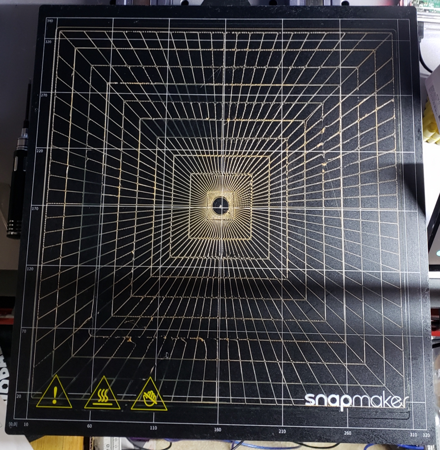

Print on manually leveled stock steel sheet
Print on auto leveled bed (same gcode for all prints)
Had to babysit the entire layer and adjust the Z offset as best as I could.

Is this data from M420V output?
What are you doing to test if the level is good?
Are you manually tweaking matrix points?
Yes that is the M420 V data rendered in Octoprint. I removed the bed heater and placed silicone o-rings on the screws between the heater plate and bed mounting plate. That allowed for some adjustability by selectively tightening or loosening the mounting screws for the heater. A tedious process to be sure and one that I hope a firmware update (or a flat replacement bed) will alleviate the need to perform.
