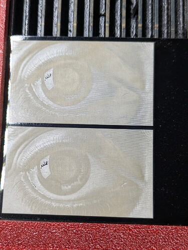

I wish I knew, but a further test shows the leaner code of GRBL actually does contribute to some finer details. While they are very minute, I was able to catch them. First; results. This was done at 9000mm/min (after changing the limits), 25% power, 0.05 interval, stucki. I also remember to invert the image. :upside_down_face:
Original:
Results: GRBL M3 on bottom, Marlin Inline on top. These are only 25mm tall, so some details will be lost from squishing the image a little.
While first glance they look the same, but tiny details came out better in the M3 version. As circled below you can see the veins in the right side of the eye, the reflections of the lashes in the iris to the left, and subsequent reflections further to the left. Also overall the colour depth seems more dynamic.
Is this major to swing one way or the other? No. Could some of it be how I took the picture? Mayhaps. I just figured it interesting and decided to share. :slight_smile: These tests were all done on aluminum business cards.
