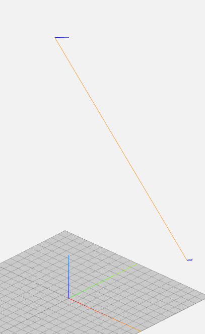

Just for discussion’s sake, the previous line was G0 X71.858 Y97.167 Z32.12.
The difference is subtle.
The original will do a straight line move from the previous position (in this case -10, -10) to a given X Y Z coordinate.
The new way it’s written will do a dog leg. It will go down to the Z value, and then sideways.
Often the difference is moot, but in some circumstances, like with a fragile print, moving sideways across a print can drag the nozzle against the model and break things.
Even just flipping that so it goes to X/Y first, and then goes to Z would be a slight improvement.
Always a good idea to preview things, I loaded your most recent edits into ncviewer and noticed that there’s no G21, which makes sure the machine is in mm units instead of inches. It’s traditional to have that in a header, so it’s not relying on the assumption the machine is configured for mm units. You should consider adding that into your Cura profile start gcode.
Apparently ncviewer assumes inches by default, so I had to add a G21 at the start of your file.
Here’s what I mean with the dog leg:
As written now:
vs how it was originally written
WAIT ncviewer noticed a problem I missed in reading the gcode. There’s a Z0 command still in the header, and that will crash through the model. Deleting the G1 Z0 F1800 line near the top looks better:
