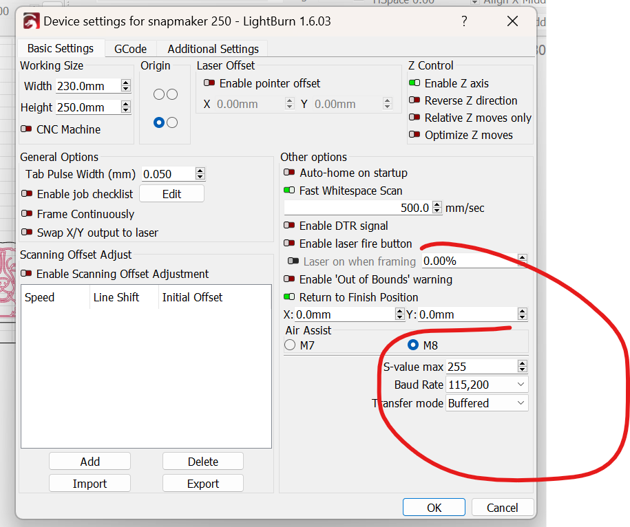

Hi - I got my A350 connected to Lightburn without any issues. However I cannot the10W laser to output enough power to make cuts. It goes about 2/3rds of the way through on an 3mm piece of wood but doesnt make full cuts. I have the settings at 180mm/min and 100% power.
I suspect the settings in Lightburn are such that the power when set to 100% is not really 100% of the actual laser.
Anyone know how to set this for the 10W laser?
Thanks!
PS the same files cut with no issue in Luban so it’s not a hardware problem.
Are the settings correct?

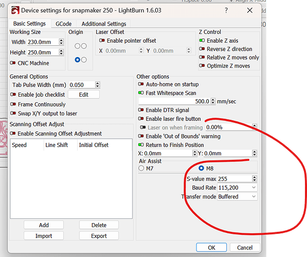

What is the max S-value max? (edit=>device settings). It must be 255.
Screen Shot 10-15-24 at 09.15 AM
Yes I believe it is 255. I will post a pic of the settings.
The firmware version of the A350 is V1.20.3_20240716
The version of Lightburn is 1.7.01
I didnt put any Gcode headers or footers into Lightburn. I use the front panel to send the head to the right job origin location (this is the location that does great cuts in Luban) and set the work to start from there via Lightburn.
Here are the line cut settings in Lightburn and Luban
The Luben does clean cuts right through the 3mm basswood. Lightburn gets about 50% through, maybe less in some areas.
Yes it is set to 255.
Could you please upload the gcode file generated by Luban and Lightburn. If the S-Value is set to 255 as it should, and you’ve set 100% power, then the gcode should be indifferent to the machine. There may be something else at play.
