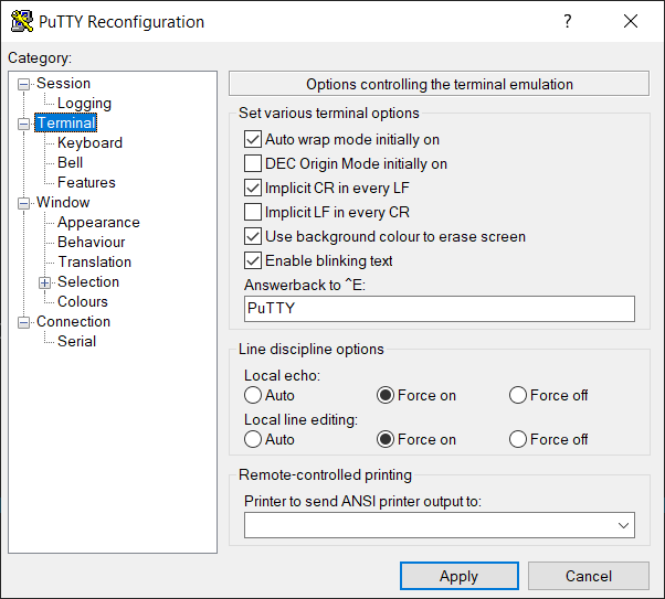

Is it doable to connect a cell phone to the machine and use a terminal program to communicate with the controller, run commands and get feedback? or do you need to have a special console to translate the marlin stuff ?
I use PuTTY. It’ll work. Straight raw serial terminal.
The controller doesn’t auto repeat, you have to enable local repeating to see what you’re doing.
dope, ive used putty a bit in the past from a windows machine
also if i can use a straight up serial terminal, i can implement PLC stuff pretty easily… that opens up some windows.
Baud is 115200 fyi. :slight_smile:
Franky gave me his config awhile ago, maybe you’ll find this useful also:
Sometimes it’s handy to turn off “close window on exit”.
