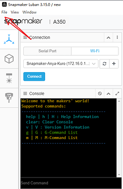

How to add own Projects File (xx.snapcnc; xx.snap3d & xx.snaplzr) to Featured Projects within Luban ? Would be very useful for our school, a kind of template ready to go for the classroom.

Sorry my question was not clear enough, my goal is to have my « Own » file saved there instead of Snapmaker proposal
For more clarification, I believe @AGentil means being able to add their own projects to the page shown in the attached image.
Exactly ! That’s my goal

The bulit-in projects are designed to help users get started quickly. You cannot upload and save your featured projects in Snapamker Luban.

After getting my hands in resources (not so simple), I managed to get this. My needs/purpose are met.

so you got it to work, can you tell us how you did it cause i can use it to easely and quickly get the same project done with nice visiuals. i tried it myself and found the place where the project is saved but if i save my own project there it wont show up.

I just redo it on Luban 4.12
(I don’t do this on a PC…sorry I’m a Mac user)
I decide to replace the Spiral Vase for my A250
Step1: going to the resource, to change the Titel Name Here Toiletsign save it
Step2: verification of new name
Step3: go to the Library (UserCase) in my case Printing section
Replace the project file with mine using the same file name !
Step4: place your icon picture of your projet with the rule as before… reuse the same name
imgSrc: “…/…/resources/images/user-case/A250/library_spiral_vase_97x97.png”,
Step 5: open and verify the new project
