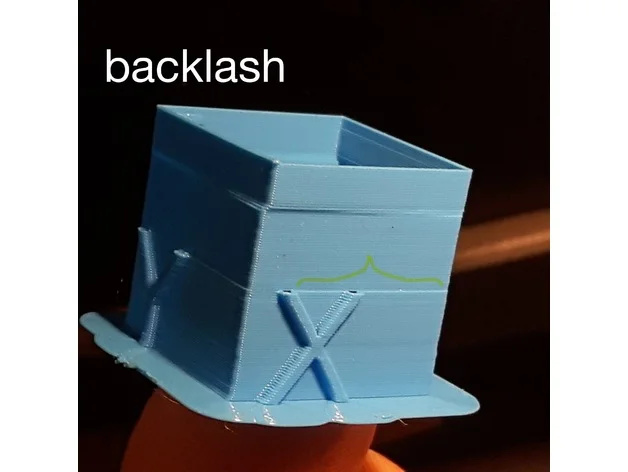

You can do that but you’re still going to have to use the leveling routines because the bed itself will have some variation. Some people have “shimmed” the bed so it’s close to level. All that still can’t compensate for play and backlash in the X,Y & Z. The best thing to do for play is tighten up the axes modules. If you tighten them up too much they will wear out faster. It’s a fairly fine art to get them just right and even then the inherit design will still have some play or flex under load. Backlash can be compensated for in the software IF SNAPMAKER WOULD JUST TURN IT ON IN THE MARLIN CODE! Hint Hint. Just let the user decide if they want it on, it can be off by default. (@whimsycwd,)
Validating that it is level is just a matter of running a dial indicator mounted on the X-axis over the surface. If you do that with the leveling turned off, you’ll see just how level it is. With leveling on, it’s just a combination of how level it really is and how well the software is leveling it. (Which can be off) I think the larger your leveling matrix is, the closer it will be able to model it but it also takes more work.

Hi, @Tone Please check M425.cpp,I think BACKLASH_COMPENSATION is on by default. I will ask someone to check it again. to see if we have broke it by accident, somehow.
We did do some research to understand this part code of Marlin last year. We conclude that it did have some effect. But it won’t be the most dominate factor in our trial experiment.
@whimsycwd David, yes, I discovered that by doing a compare on the source code. I don’t think it is “on” by default but it is enabled which lets us turn it on if we need to. I don’t recall seeing that mentioned in the release notes but I could have missed it. I’ll go back and read them again. It may be used in the leveling routines which could help out there. I would encourage your team to be very complete in describing what has changed in the release notes. I’m also glad to see what their future plans and priorities are, that lets us see the direction things are going and let’s us comment on them. The more communication the better. THANKS.
@Tone
Hi Tone, this is Scott form Snapmaker FW team. The main reason didn’t mention BACKLASH in release note, is that we think this feature is not completely enabled in our machine. As you said, users need to turn it on by themselves.
“Completely” means we need to perform enough tests to make sure it is effective and safe for most users. But recently, we focus on code refactoring, and preparing for FW open source. For now we have enabled FreeRTOS V10.3 in FW and testing its stability&reliability. We will continue to optimize the FW feature in next cycle.
