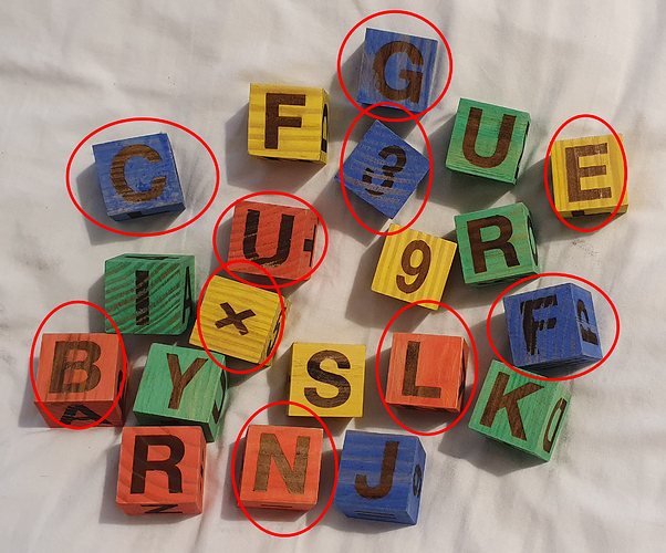

Some people will have seen the laser etched blocks I produced as my first project with SM1. I was pleased with the results and determined to make a few sets of kids toys with alphabet blocks. I also experimented with colour but it proved more difficult to solve the issues thrown up with non-toxic paint finished for young children. In the end I found a non-toxic poster paint but was not happy with the overall result. The image below might be informative…
The wood is pine and I had not realised just how difficult it would be for the laser to etch the much harder wood of the annular rings. In fact in many cases, the laser did not touch the harder wood even on 100% power for the 1600mW upgraded version.
I had idly wondered whether something in the paint was protecting the wood from the laser beam. It was a newbie’s stupid thought really as the next image is shown with plain blocks. Remembering how successfully I had engraved the first wooden blocks from exactly the same source.
The letter M on the left of the image shows the quality I was getting initially. the blocks inside the red ellipse show what the quality is like on the a few of the batch of 1200 blocks I had purchased. A complete newbie error made because I had no idea how much wood varied in its grain or hardness. If I work on the principle that the batch of blocks I purchased are all going to give me some sort of issue (these blocks were randomly selected from a box of 400 blocks) then a solution needs to be found.
