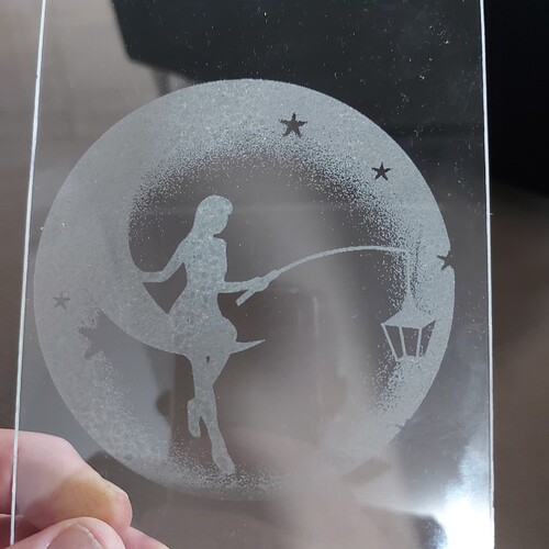

10W Laser-Clear acrylic engraved : The most iconic landmark of Greece
Nice job!
Did you masked the acrylic sheet before laser engraving? Which settings did you use?
I’d like to know too please…
Please let us know your process and settings!
Hi all and sorry for the late response.
  1. I mask the acrylic with liquid chalk marker or spray. Spray is better because the marker creates ā€œlinesā€ that might be visible on the engraved pattern/photo, especially if it contains large engraved areas.
  2. I use dot fill engraving settings for basewood but I change the power to 35%
  3. For better clarity I make 2 passes, by just copying the initial toolpath in order to have the exact same coordinates.
This was done with 1600MW laser .spray on chalk paint, light yellow all i could get.
3mm acrylic 0.2 dot fill 6 dwell time. 75% power. 1 pass.
Will try one at 100% and see.
How you remove the Chalk after the Laserprozess?
Just wash it out under tap water. The nature of chalk paint is to dissolve under water.
