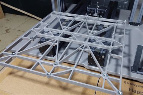

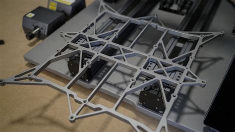

Is there a possibility I dont have the v2 bed frame? Iāve never received a new one although my machine may have come with it depending on its release. I believe I got it late 2022 in December although Iām not sure.
Possibly, but unlikely. The v2 bed frame was shipping with new machines as early as April 2021 (when I purchased mine). Itās easy to figure out which one you have just by looking at it though.
This is the v2:
And this is the v1:
As for the error you are getting, have you verified on the touchscreen that your 3DP module is actually being detected properly? I would try shutting the machine off, unplugging the power, and then unplugging and re-plugging the 3DP toolhead module and the heated bed, making sure the connectors are oriented properly and fully seated, then turning the machine back on.
