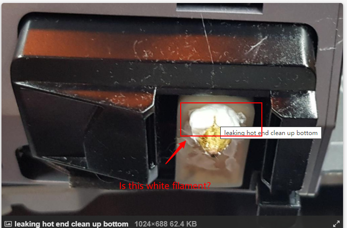

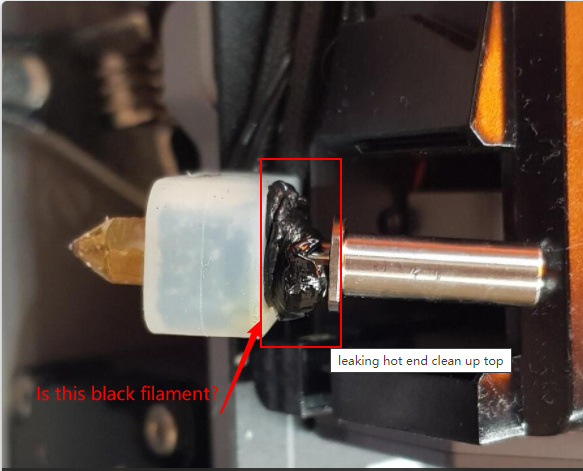

this was ‘box fresh’ I had assumed everything should be ready to go from the spares pile. I have cleaned up the nozzle and attempted to reuse but it is still leaking under pressure.
I have contacted support and have some replacements on the way.

Several simple questions for you.
  • Is this thing the white filament?
  • Is this the black filament?
  • Does this issue happen when you used the hot end for the first time?
Looking forward to your reply.
I was using black filament for a couple of prints and then swapped it to white. When I noticed the white coming out around the nozzle I pulled the hot end out and spotted the black had oozed out the top.
