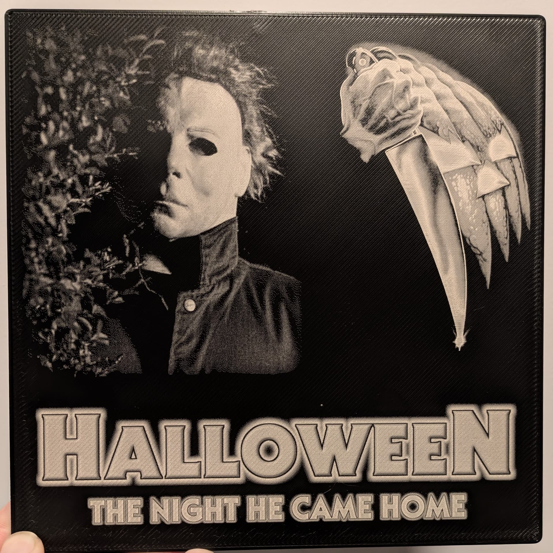

Co-worker of mine loves the Halloween series, especially the original. He asked if I could make him something to hang up in his garage, and this is what I came up with. 200x200x2 black PLA, engraved with the IR laser, 45% power, 6000mm/min, 0.09 interval.
Nice. You should do matching plaques with all the sequels…
Looks great, thanks for sharing!
