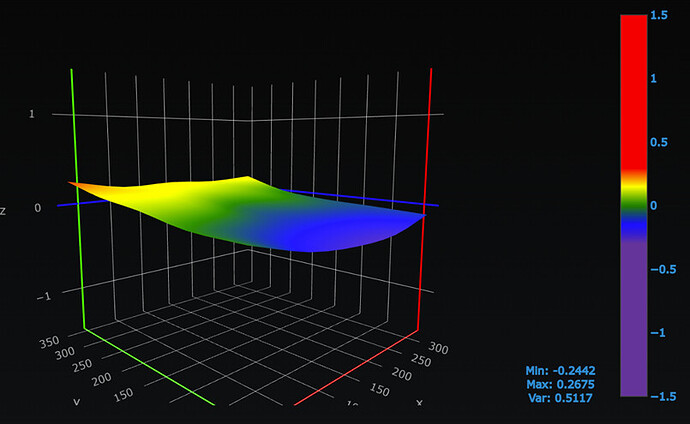

  1. well they seem to have accepted my PR on heated G1029
  2. i am in middle of some testing snapmaker asked me to do (various mesh sizes and report out)
  3. thought i would throw some heated into the mix…
This is test using touchscreen and stock build surface.

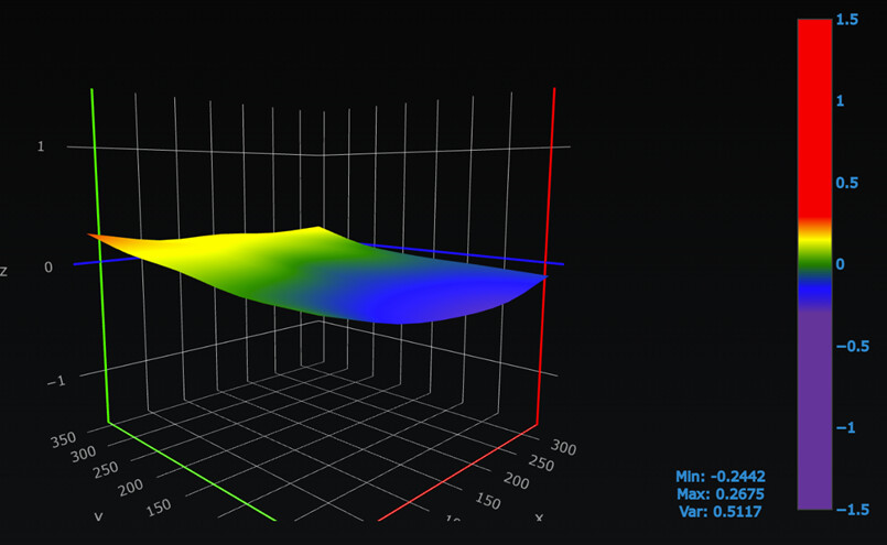

5x5 ambient (about room temp)
5x5 70c
next up repeat with energetic PEI to see if this is platform or build plate differences in heat (along with the other tests they asked me to do).
(I did, FWIW, validate that touchscreen 5x5 cold and G1029 5x5 cold produce the same results)
Is this with the new rails or FW14? For me, the mesh is always at ~z6, but yours is at 0.
It’s also really interesting to see that heating changed not only the shape, but also increased the floor by ~.25mm (that’s a whole layer!)
tl;dr its likely because i ‘use relative z offsets’ in the plugin config (which is the default IIRC)
Well i adjusted the scale in octoprint - but it always shows Z=0 as once the point is set via G1029 or touchscreen calibration z=0, thats the way the octoprint plugin works and snapmaker works - z always = 0 on the touchscreen too… unless you have done something ‘interesting’
The M420V data on mine is no different to yours.

the issue is the video is not the same as the issue in the two heat maps above
i have reproduced the issue on multiple build surfaces including glass
snapmaker have all my detailed testing and continue to investigate (and confirmed the issue on one of their own machines)
