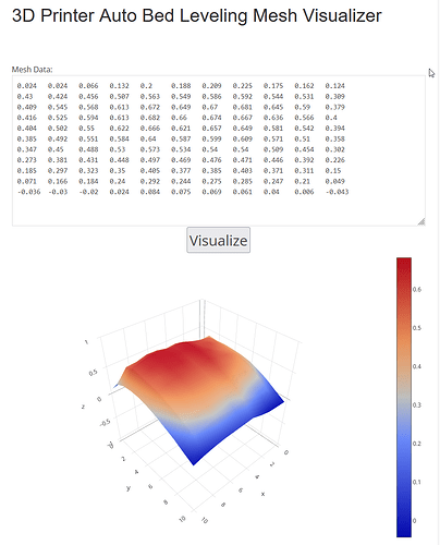

Setting myself up for adventure here :slight_smile: Started to get bad first layer in some areas.
run auto leveling with 11x11 with the print sheet I use all the time and then replaced the sheet with new.
Old sheet ^
New sheet ^
Update
(5x5 mesh) + used snapmaker printing sheet and some HVAC tape.
After spending half a day cutting up HVAC tape to squares (0.07mm thick) and applying in to the the platform I got to this.
Thank you for the writeup @Mxbrnr. I’m going to leave it like this until I get my G10 surface.
Wow! A delta of only 0.086mm, basically the same as the smallest layer height you can print with the SM (0.08mm). Well done!
