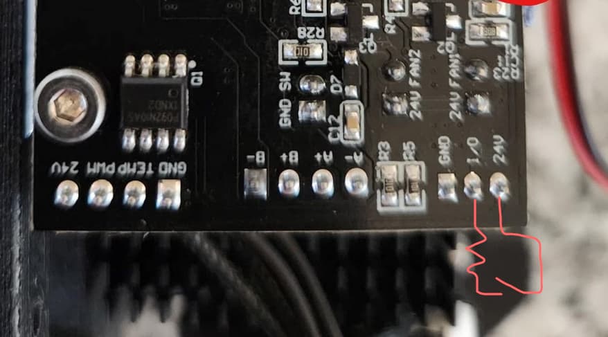

So the controller uses NPN (sinking) inputs. I believe the existing sensor was normally open. The filament runout may have been normally closed.
Most dry switches can be wired for either NO or NC, so that parts a bit easier to deal with. The main trick is to know that the switch common needs to go to 24VDC negative (24vdc-) for it to register as an input.
That looks like an interesting device
@MooseJuice would this work? I’m a noob in circuitry design tho.
No, 24v is going to be 24vdc+, which would be the correct pin if the inputs were sourcing / pnp. the input needs 24vdc-, which they have labeled as GND (ground).
If that i/o pin is the correct input, which i dont remember if it is or not, you would need to use that and GND.
I can take mine apart tomorrow to double check.

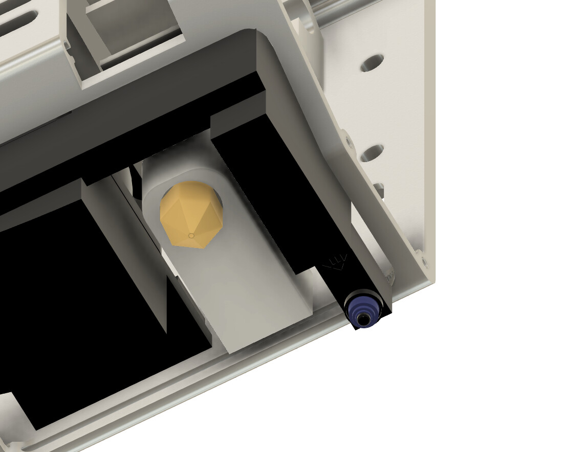

Can’t come up with deployment mechanism simple enough to implement inside the stock housing.
Switch actuation force is 70gr., the Fan shroud side would have to be removed to clear the switch, but it’s not used for airflow anyway.
