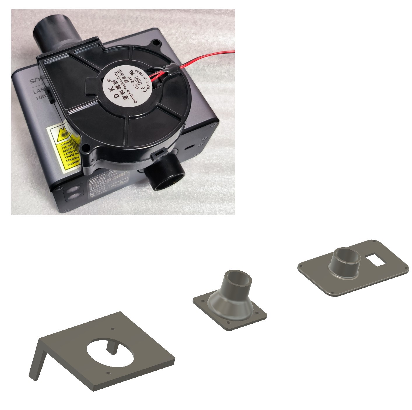

Thanks for posting the very good countermeasure plan.
The measures are as follows.
Model the top panel of the 10W laser with a 3D printer and provide external suction from outside the enclosure.
Create a bracket with a 3D printer to attach a blower fan on the full side of the 10W laser and force exhaust.
Drill a 40mm hole in the enclosure with a hole saw and install a 50mm x 50mm 24V fan to increase the amount of external intake air to the top of the 10W laser.
We decided to modify the enclosure for the idea that it should not suck in wood dust that was convected inside the enclosure in the first place.
 ![10ｗ](https://us1.discourse-cdn.com/flex022/uploads/snapmaker/original/3X/2/d/2df8a9c7d92549370355a3d9af61875b86b50e25.jpeg)

**Author:** ![Blockmodule](https://sea2.discourse-cdn.com/flex022/user_avatar/forum.snapmaker.com/blockmodule/32/11177_2.png) [@Blockmodule](https://forum.snapmaker.com/u/Blockmodule)\
**Post date:** [January 19, 2024, 2:06pm UTC](https://forum.snapmaker.com/t/wood-powder-accumulates-inside-a-10w-laser/34539/5 "2024-01-19T14:06:28Z")
Hello. - Hello.
Thanks for the reply.
Do I need to use a 70x70 24v fan to maintain airflow?
I will verify this with a 50x50 24v fan.
I have finished the design in Fusion360 but have not been able to mold it due to work, so I will report back when I have the results from the modification.
**Post date:** [January 24, 2024, 10:12am UTC](https://forum.snapmaker.com/t/wood-powder-accumulates-inside-a-10w-laser/34539/13 "2024-01-24T10:12:43Z")
I use the same external exhaust fan.
I bought it 2 years ago on AliExpress for 3000 Japanese yen.
About $20?
It exhausts quite a bit and is the most stable.
However, there is a possibility of ignition if you don’t clean it regularly.
It is very difficult if you forget to maintain it.
I made a part to introduce outside air for 10w laser.
I haven’t had time to finish it yet, but I’ll report back.
**Post date:** [February 3, 2024, 12:14pm UTC](https://forum.snapmaker.com/t/wood-powder-accumulates-inside-a-10w-laser/34539/15 "2024-02-03T12:14:38Z")
Thank you for the advice. By using external air intake, the 10W laser can now be maintained in a clean state. Even with a 30mm pipe, combining it with the blower fan ensures sufficient heat dissipation and exhaust clearance.
For those using a 10W laser or similar, please make sure to perform maintenance regularly to prevent breakdowns.
**Post date:** [February 4, 2024, 5:12am UTC](https://forum.snapmaker.com/t/wood-powder-accumulates-inside-a-10w-laser/34539/17 "2024-02-04T05:12:43Z")
The intake side of the 10W laser module is an external air intake with a hole drilled in the enclosure and an air filter attached. ☹
Is it just sucking in debris…
You’ve been using it for 2 years without any issues, but that doesn’t necessarily mean others won’t have the same problem.
For those working with materials like MDF using the enclosure, there tends to be significant buildup (as shown in the initial posted photo).
I have another setup with a 10W laser cutting “something” every other day, producing items for sale, and there is no accumulation there.
**Author:** ![snapUser](https://avatars.discourse-cdn.com/v4/letter/s/e19b73/32.png) [@snapUser](https://forum.snapmaker.com/u/snapUser)\
**Post date:** [February 4, 2024, 6:01am UTC](https://forum.snapmaker.com/t/wood-powder-accumulates-inside-a-10w-laser/34539/18 "2024-02-04T06:01:13Z")
I’d be more inclined to put a vacuum nozzle external on the module. Extracting fumes, debris right off the cutting surface vs pulling them thru the module. But hey whatever works for you.
**Post date:** [February 4, 2024, 7:06am UTC](https://forum.snapmaker.com/t/wood-powder-accumulates-inside-a-10w-laser/34539/19 "2024-02-04T07:06:00Z")
Hello snapUser,
It appears that there might be a misunderstanding on your part.
The top of the 10W laser is sending air from outside the enclosure. Air flows from the top to the bottom of the 10W laser. Some of it is expelled to the outside through the fan on the left side of the electronic board of the 10W laser.
By directing airflow from top to bottom towards the laser processing area, it is possible to prevent discoloration due to laser burning.
Creating a system to flow air into the cylinder below the laser output is simpler than using an air pump. No air pump is necessary.
Increasing the airflow from outside the enclosure using a blower fan further enhances the effectiveness.
Why there are elements to intake dust or debris from outside the enclosure is a question to consider…
