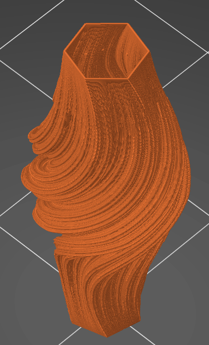

I tried to slice a Koch vase STL in vase mode with the latest Luban version, and the resulting gcode looked unprintably awkward with hundreds of nonsensical bridge lines within the model (vase mode should print only the outer surface…).

Luban 4.8.0, File: [Printables](https://www.printables.com/model/75521-fractal-flake-vase)
Vase Mode awkwardness (no matter if file is loaded with or without repairing model)

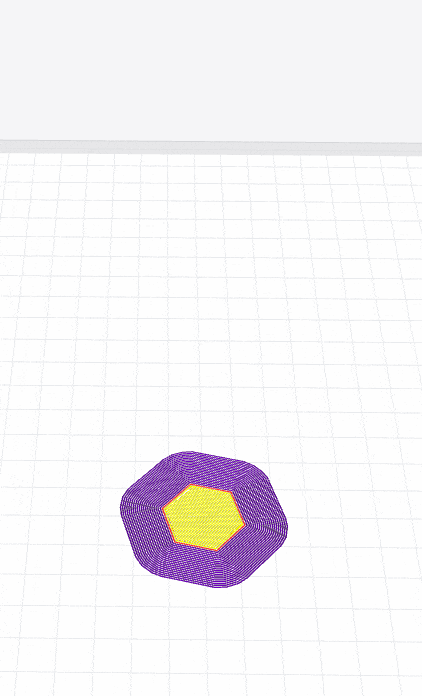

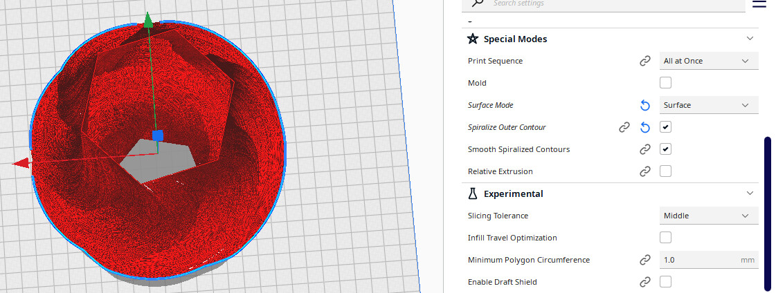

Cura 5.3.1, Snapmaker Plugin 0.9.0
weirdness gone after slicing in Cura with vase mode (printer settings follow exactly the defaults for A350 single extruder)

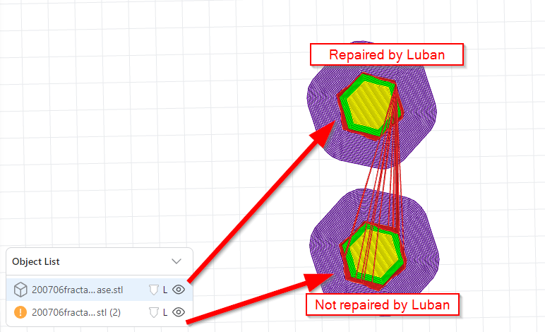

Then I tried loading it to Luban 4.8.0.
Luban thought the model is broken and asked if I want to repair it. I said yes and after some thinking it sliced it alright.
 ![image](https://us1.discourse-cdn.com/flex022/uploads/snapmaker/original/3X/b/b/bb9a4117ee8710db8ee8c3c1efbba5a69248329c.png)
 ![VaseSliceLubanRepaired](https://us1.discourse-cdn.com/flex022/uploads/snapmaker/original/3X/8/b/8b27391fe0ca86335c343c97aa378c4c1be3c8bb.gif)

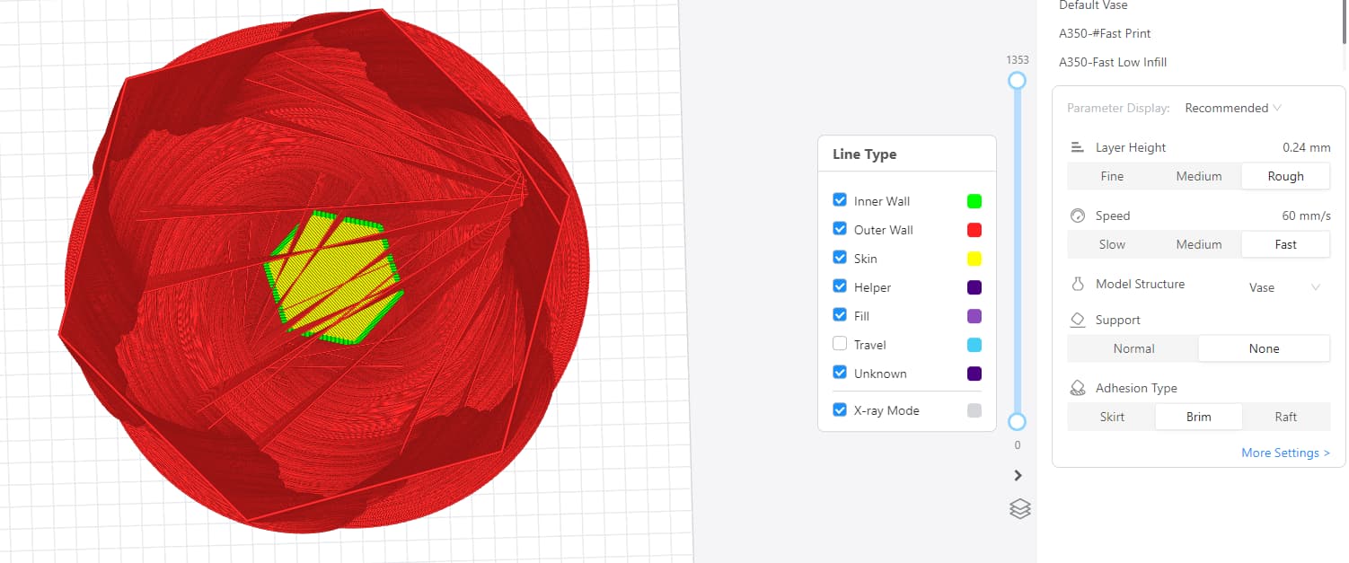

Then I loaded the model again, but refused to repair it, and that is where problems you describe, appeared.
 ![image](https://us1.discourse-cdn.com/flex022/uploads/snapmaker/original/3X/6/3/63e9d75c97392edbf19fa5dcc8c711f83badc9cf.png)
I’m guessing core luban is using outdated algorithms for slicing, maybe this part wasn’t updated since they forked the cura.

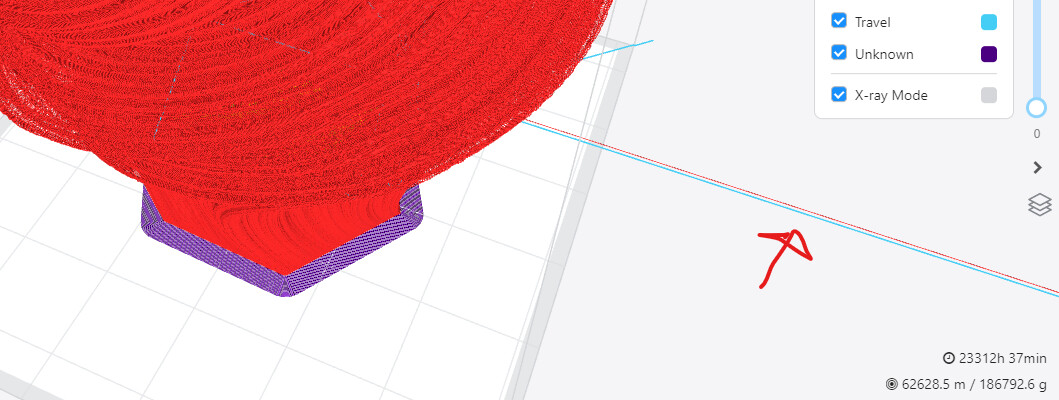

Based on your feedback that a somewhat functional vase mode slice of this model is _possible_ in Luban I narrowed the success/failure parameters down to SCALING (that means irrespective if the model is “repaired” or not upon load, the model fails to slice properly when scaling the model to fit the build space (i.e. 241.6% for my A350)), but works fine when, as you say, repairing and sticking with 100% build size.
1. I could also get a much better slice in Luban when using “simpify”-\> “Scale by layer height” (only one erroneuos internal bridge left, even at 241.6% scale).
2. This works with some limits, in some other scalings (especially non-uniform scaling) it creates new fun glitches such as an eternally long line
 ![image](https://us1.discourse-cdn.com/flex022/uploads/snapmaker/original/3X/4/0/40407a6a485940d29b6b01fdd082e1f7f23129e4.jpeg)
