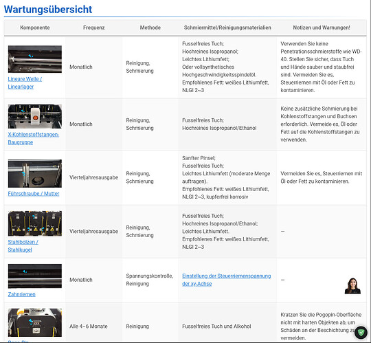

Hello.
All of you who have had the U1 for a while: Does it notify you via software when maintenance is due, or do I need to schedule this in my calendar?
Once a month can make a significant difference for a heavy user compared to a light user.
How do you handle maintenance?

That’s all very well, but how / who determines the thresholds which trigger the “service light”? Without data, it’s pointless.

So: Does software trigger a “service light”? Apparently, not at the moment.
Does he need to schedule it in his calendar? Personally I would wait until print quality starts deteriorating and then find out why. However, if you’re involved with time-critical work and can’t accommodate interruptions for remedial action and reprinting, you might want to take pre-emptive action – ie have a routine maintenance schedule – but that’s going to be very user specific, and will sometimes be time spent that wasn’t necessary.
Perhaps this thread could serve as a notepad for people to record their experiences. Have you had to re-adjust belt tension, or replace a belt, or whatever… and after how many print hours?

I adhere quite strictly to my own “calendar,” but I always clean and service the printers immediately after any error occurs. Since the U1 has had not a single misprint to date, they receive their maintenance every Wednesday evening. During this process, the axes and spindles are cleaned with IPA, and metal parts are oiled/greased (lithium grease).
Additionally, all transparent surfaces, as well as all print beds, are cleaned with a mixture of dish soap, warm distilled water, and IPA.
Finally, a complete calibration is performed. I have adapted the scripts to run automatically without user intervention, as I do not wish to stand waiting in front of the printer during calibration: at the beginning, I remove the build plate from the bed and clean the nozzle before each calibration—this way, I do not have to confirm the action on the display every time.
My other printers (BAMBU/QIDI) are also cleaned and serviced, and I can say that their last errors occurred several months ago—it seems to do no harm to dedicate 1-2 hours per week to the proper care of one’s devices.
PS: As a craftsman (electrician), I do the same with my work tools and their cases: the drill, cordless screwdriver, angle grinder, and multitool are cleaned of dust and dirt on the last working day of the week; all movable metal parts are oiled/greased, and the batteries are fully recharged. The tool bag is completely emptied, vacuumed, and restocked with tools.
A clean presentation to the client always leaves a good impression; the clean and orderly work delivered as a result almost always leads to referrals, and to this day, I have never had to chase after an invoice or advertise:slight\_smile:…

There seems to be a misunderstanding: I do not add any chemicals beforehand; instead, I manually clean the spindles and axles first, then remove the print bed, and only after that do I run the 4-head calibration script.
I also manually clean the nozzles before running the script—if it’s even necessary, since I usually skip this step because the cleaning wipers in the U1 do an excellent job, and the hardened nozzles are already very clean after printing.
After that, I place the print bed back on, perform a full Bed Leveling and Vibration Compensation cycle.
This means that after cleaning/maintaining the spindles and axles, I need to visit the printer exactly twice: once to remove the print bed and once to put it back on. In between, the script runs automatically.
Your idea of an “off-time maintenance calibration,” similar to the one on Bambu printers, is also excellent and definitely worth a closer look. Thank you very much for this suggestion!
