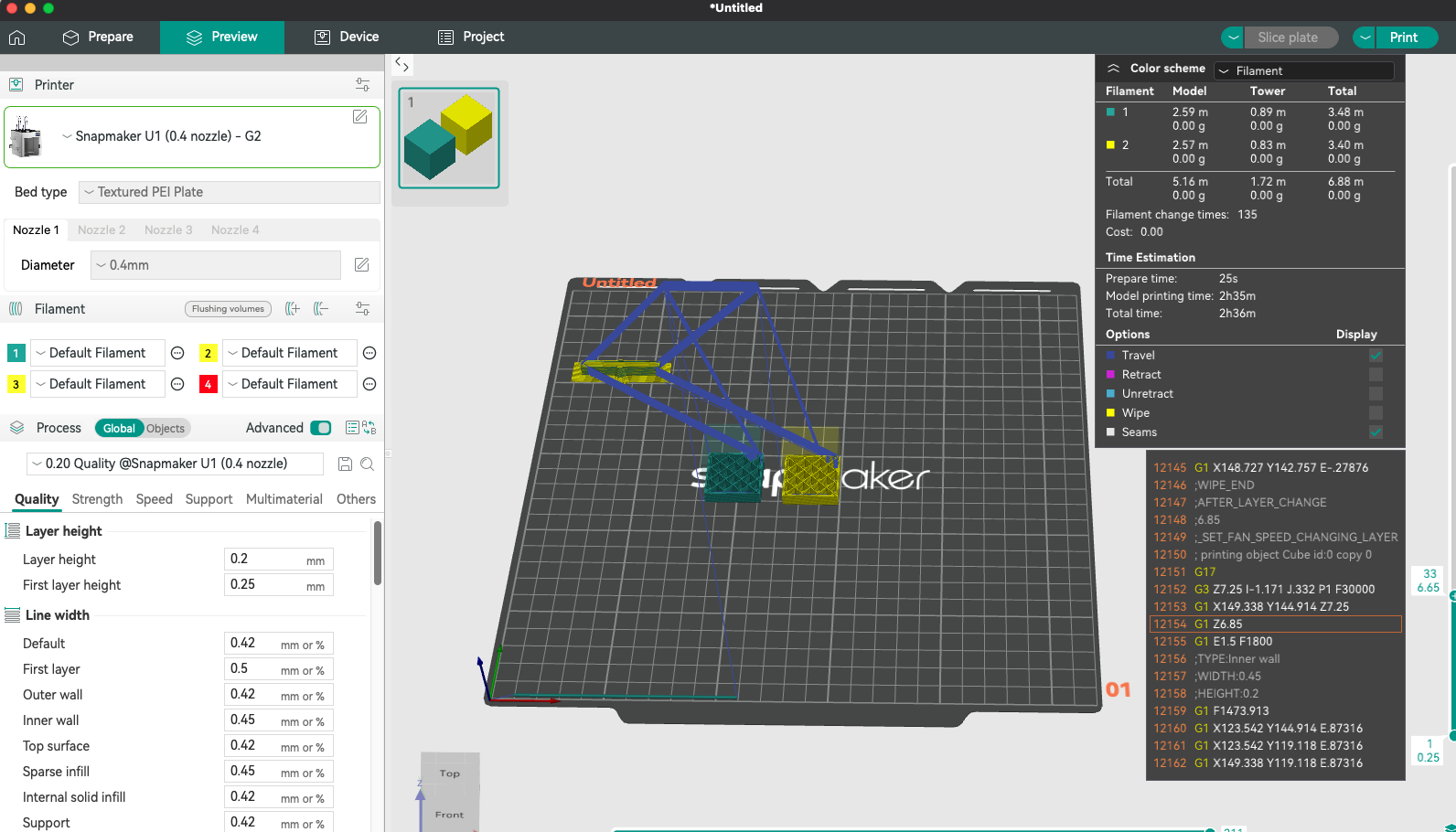

As Orca Slicer doesn’t really know about the position of the tools, when you visualise the moves within Orca slicer, when a tool change happens - Orca shows the print head doing the following:
1. Moving directly to the prime tower - Which is not correct - because surely it moves to the tool drop off / preheat point first
2. Then moving straight from the prime tower back to the print
Example here
 ![Screenshot 2025-10-31 at 09.29.25](https://us1.discourse-cdn.com/flex022/uploads/snapmaker/original/3X/7/f/7f40c1cc11ac443ed555af6b889b5d7e9732ad3b.png)
For prints where the filament numbers exactly match the tool numbers I have made a small change to the Change Filament Gcode - just really for visualisation purposes - and possibly not completely accurate - but I thought it might be of interest.
Suggestion in next two replies to this post - as new users can’t post more than one image.

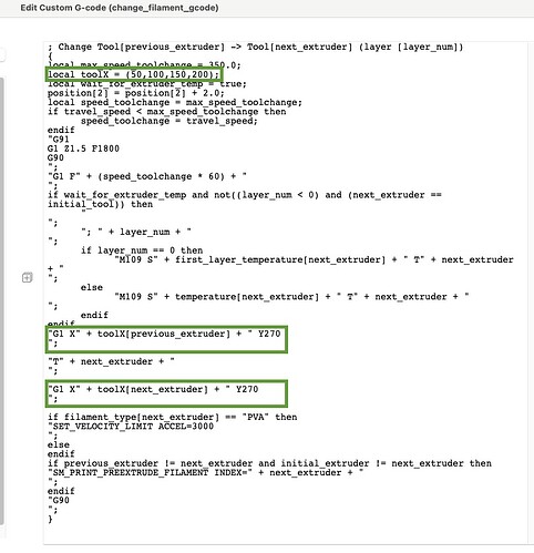

I made these 3 simple changes to the printer Config Gcode overrides to show this visualisation
