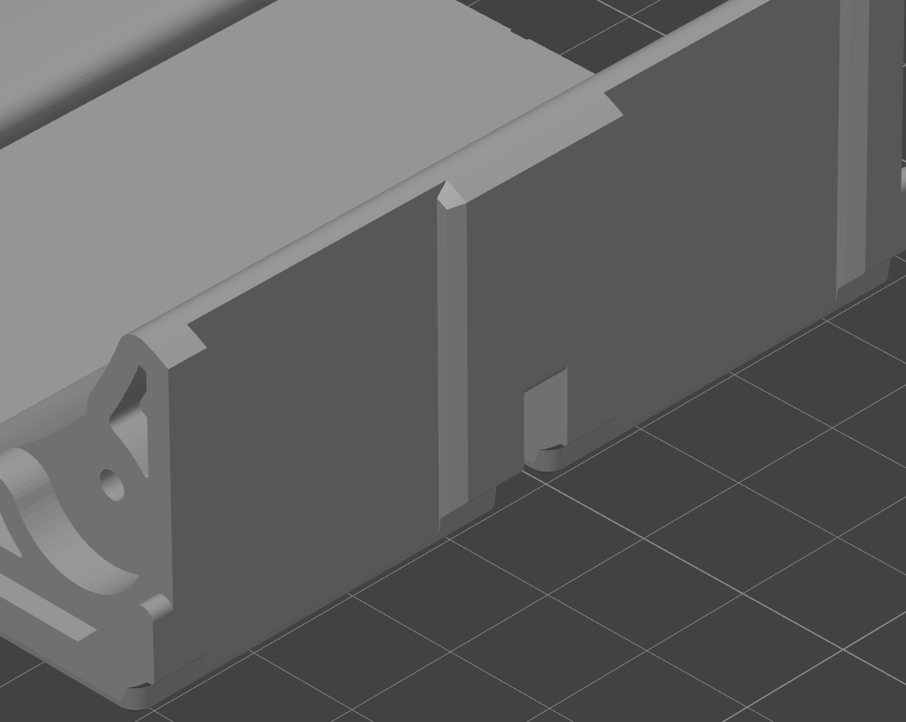

So, the base files look fine to me.
 ![image](https://us1.discourse-cdn.com/flex022/uploads/snapmaker/original/3X/5/2/521eeea4f228cf862fd7516b228c9b227d3fc37b.png)

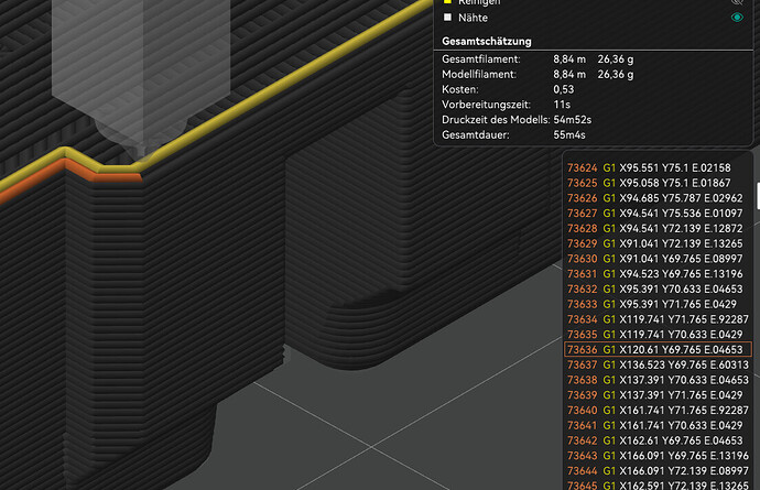

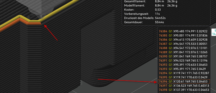

Following up on that, I examined the GCODE across different layers at the same locations after slicing.
 ![image](https://us1.discourse-cdn.com/flex022/uploads/snapmaker/original/3X/7/a/7a80b5d680480a0b543ab5a7a426228fe0b9843d.jpeg)
 ![image](https://us1.discourse-cdn.com/flex022/uploads/snapmaker/original/3X/9/6/96b2040fbf1997ef097ce0ba786b08e41ebd36ad.jpeg)
In the various layers, the same XY coordinates are always approached with G1 parameters. In my opinion, this indicates that the model/STL has smooth walls.
Or am I seeing this wrong?
Therefore, something must be wrong with the printer, your print settings, or the filament. It cannot be the STL file.
Please try using a different filament for testing.
