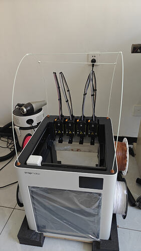

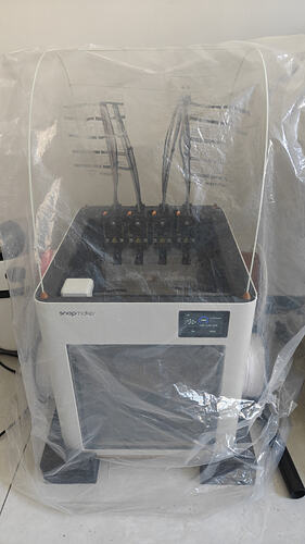

More affordable U1 box sealing
Materials: “1-meter long fiberglass rod, solid glass fiber rod for takeout thermal box support rod, hard plastic resin rod” 2.5mm*2
Use 502 glue to bond the fiberglass and the printed part, and use soft glue (for bonding phone frames/leather/fabric, etc.) to bond the printed part and the printer.
Maintain the chamber temperature at 43~55 degrees, with the temperature slowly increasing over the printing time.
Download link for the printed part: https://1811793662.share.123pan.cn/123pan/YaADVv-Bz993?pwd=VyZH#
