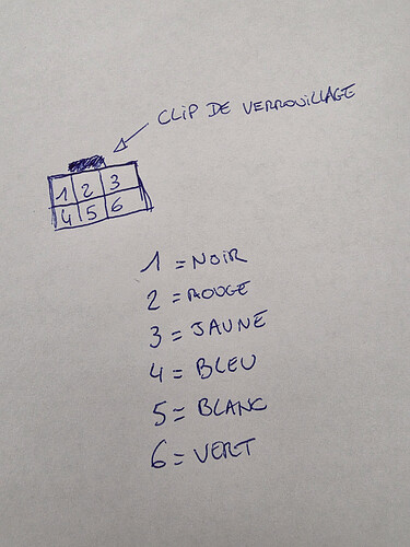

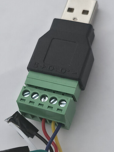

**Author:** ![jojothemulet](https://avatars.discourse-cdn.com/v4/letter/j/f4b2a3/32.png) [@jojothemulet](https://forum.snapmaker.com/u/jojothemulet)\
**Post date:** [September 26, 2026, 9:16am UTC](https://forum.snapmaker.com/t/u1-multi-ace-pro-integration-stock-firmware-no-soldering/41596/411 "2026-09-26T09:16:41Z")
![20260926_104043](https://us1.discourse-cdn.com/flex022/uploads/snapmaker/original/3X/c/b/cb1142a6b397da224068a6ed754c13a2dea33172.jpeg)
 ![20260926_110242](https://us1.discourse-cdn.com/flex022/uploads/snapmaker/original/3X/b/d/bd889e52354caff2f5d50c3cb567f813e172fde9.jpeg)
Hello, I bought a 6-pin Molex cable to connect my Ace Pro V1 (the one from the Kobra S1C).
I identified the pinout of the connector with the locking clip on top… as shown in the photo… and I connected the D+, D-, and GND pins…
Is this wiring correct, please?
**Author:** ![decay71](https://sea2.discourse-cdn.com/flex022/user_avatar/forum.snapmaker.com/decay71/32/32234_2.png) [@decay71](https://forum.snapmaker.com/u/decay71)\
**Post date:** [September 26, 2026, 2:07pm UTC](https://forum.snapmaker.com/t/u1-multi-ace-pro-integration-stock-firmware-no-soldering/41596/412 "2026-09-26T14:07:36Z")
Here is the pinout for the 6 pin connector
> **[GitHub - BlackFrogKok/SnapAce](https://github.com/BlackFrogKok/SnapAce)**
> Contribute to BlackFrogKok/SnapAce development by creating an account on GitHub.
**Author:** ![Dragg30](https://sea2.discourse-cdn.com/flex022/user_avatar/forum.snapmaker.com/dragg30/32/33528_2.png) [@Dragg30](https://forum.snapmaker.com/u/Dragg30)\
**Post date:** [September 26, 2026, 4:10pm UTC](https://forum.snapmaker.com/t/u1-multi-ace-pro-integration-stock-firmware-no-soldering/41596/413 "2026-09-26T16:10:08Z")
Rouge D+ Jaune D- blanc Gnd
Note that this refers to the pins when you look at the ACE, not your cable. I have doubts about your schematic.
**Post date:** [September 26, 2026, 4:36pm UTC](https://forum.snapmaker.com/t/u1-multi-ace-pro-integration-stock-firmware-no-soldering/41596/414 "2026-09-26T16:36:15Z")
Indeed, the colors I indicated are those seen when looking at the Molex cable specification sheet from the front, not the Ace Pro… I’ll redo everything based on the diagram with the link provided above… Thanks a lot.

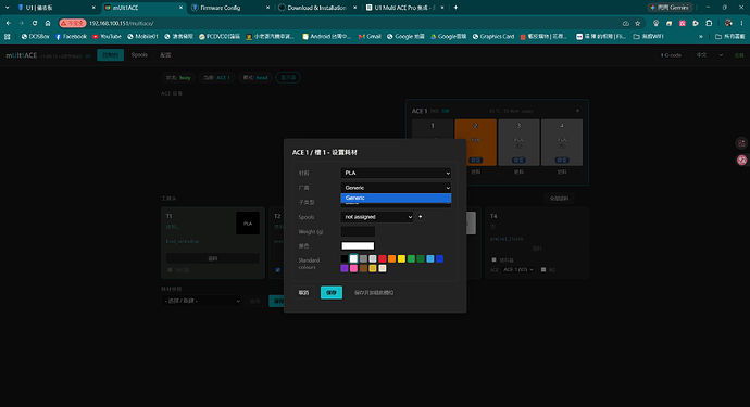

**Author:** ![david123761](https://avatars.discourse-cdn.com/v4/letter/d/a87d85/32.png) [@david123761](https://forum.snapmaker.com/u/david123761)\
**Post date:** [September 29, 2026, 9:31am UTC](https://forum.snapmaker.com/t/u1-multi-ace-pro-integration-stock-firmware-no-soldering/41596/418 "2026-09-29T09:31:48Z")
Does this mean we can no longer select a wire manufacturer??
 ![image](https://us1.discourse-cdn.com/flex022/uploads/snapmaker/original/3X/7/f/7f701fbb914324aa487142d2f96881114a63749e.png)
**Post date:** [September 29, 2026, 9:48am UTC](https://forum.snapmaker.com/t/u1-multi-ace-pro-integration-stock-firmware-no-soldering/41596/419 "2026-09-29T09:48:14Z")
> [@david123761](#):
Hi, thanks for the report. That is a regression on my side: on firmware newer than 1.5.2 the vendor list only shows Generic, because our reader of the new filament database skips the Snapmaker and Polymaker rows. Fixed in the next hotfix.
**Post date:** [September 29, 2026, 2:15pm UTC](https://forum.snapmaker.com/t/u1-multi-ace-pro-integration-stock-firmware-no-soldering/41596/423 "2026-09-29T14:15:55Z")
Thats it, regression starts with fw \> 1.5.2
**Post date:** [September 29, 2026, 5:06pm UTC](https://forum.snapmaker.com/t/u1-multi-ace-pro-integration-stock-firmware-no-soldering/41596/424 "2026-09-29T17:06:18Z")
1.11b hotfix is out, fixes that.
