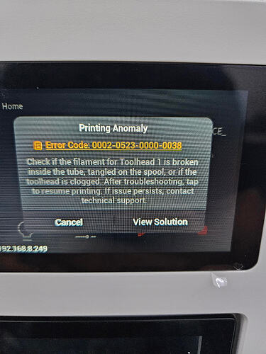

I have everything installed and working, but I keep getting this error every few minutes constantly, without any bottlenecks or anything like that. If I press “resume,” it prints fine again, but less than a minute later, it stops and shows this error again. I’m posting here because I don’t know where to report issues on GitHub. Sorry about that. I would appreciate some help. Thanks in advance.

**Author:** ![decay71](https://sea2.discourse-cdn.com/flex022/user_avatar/forum.snapmaker.com/decay71/32/32234_2.png) [@decay71](https://forum.snapmaker.com/u/decay71)\
**Post date:** [May 31, 2026, 4:34pm UTC](https://forum.snapmaker.com/t/u1-multi-ace-pro-integration-stock-firmware-no-soldering/41596/32 "2026-05-31T16:34:45Z")
> **[Issues · decay71/multiACE](https://github.com/decay71/multiACE/issues)**
> Multi-ACE Pro integration for Snapmaker U1 - new Version 0.97b "Kindred Allies" + ACE2 support, Web UI, Web Preflight, Inprint-Swaps, cross Ace Filament usage, auto-detection, hot-swap, ...
Disable Air Print Detection
**Post date:** [May 31, 2026, 6:28pm UTC](https://forum.snapmaker.com/t/u1-multi-ace-pro-integration-stock-firmware-no-soldering/41596/33 "2026-05-31T18:28:30Z")
I’m getting the same error but only on tool head one. Like you said hit resume & it will start printing for awhile. I’m not using the Multi ACE Pro. I’m going to bypass my feeder & see if I still get the error.
**Author:** ![tayson\_bull](https://avatars.discourse-cdn.com/v4/letter/t/82dd89/32.png) [@tayson\_bull](https://forum.snapmaker.com/u/tayson_bull)\
**Post date:** [May 31, 2026, 8:10pm UTC](https://forum.snapmaker.com/t/u1-multi-ace-pro-integration-stock-firmware-no-soldering/41596/35 "2026-05-31T20:10:39Z")
This seems to be working for me for now. Thank you very much, I’ll keep testing everything.
