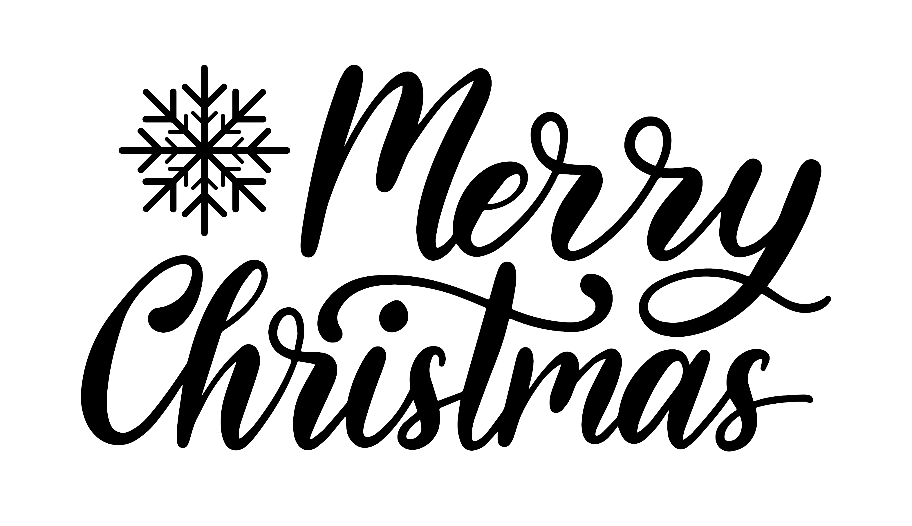

For the life of me I cannot figure out why some files work fine on here and other do not. Can someone please tell my why this PNG file is not working? This should not be this difficult. This is on version 2.4.4. I can load the file in, preview, generate the GCODE and when the workspace screen opens I get a black box with a bunch of lines when when I start the print that is exactly what it prints. I black box.
#100
Remove the transparent layer of png file will do the work.
