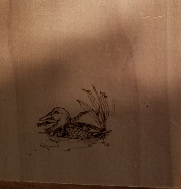

#20
@whimsycwd
David Attached is a picture of a line drawing of a woodland duck that I was able engrave using Snapmakerjs-2.2.2-win-x64.exe (I upgraded from Snapmakerjs-2.1.1-win-x64.exe this evening). After a bit of experimenting I found that the engraving head should be about 1 1/4 inch (31.75 mm) above the popular block when the power was set at 80% and the Jog Speed was 300. I have also attached a copy of the G Code file that I generated while working on this engraving.
20780709_20780708_ducks 2.nc (263.9 KB)
Woodland Duck Engraving
