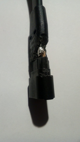

This was the faulty pin and cause for not able to connect. When tested with the multimeter it did not have connection from end to end
![](https://us1.discourse-cdn.com/flex022/uploads/snapmaker/original/2X/3/364a5e2017ac6f9c86bc3ad1378e65087161ac38.png)
**Author:** ![fillngraves](https://sea2.discourse-cdn.com/flex022/user_avatar/forum.snapmaker.com/fillngraves/32/3397_2.png) [@fillngraves](https://forum.snapmaker.com/u/fillngraves)\
**Post date:** [January 22, 2020, 2:15pm UTC](https://forum.snapmaker.com/t/touch-screen-not-working-after-assembly/4958/14 "2020-01-22T14:15:37Z")
Any way to disassemble this cable in order to make the repair until a replacement cable can be sent from Snapmaker… I’d really hate to wait weeks or months for just a cable…
**Author:** ![kastrolis](https://avatars.discourse-cdn.com/v4/letter/k/34f0e0/32.png) [@kastrolis](https://forum.snapmaker.com/u/kastrolis)\
**Post date:** [May 1, 2020, 10:19pm UTC](https://forum.snapmaker.com/t/touch-screen-not-working-after-assembly/4958/15 "2020-05-01T22:19:53Z")
![cable1](https://us1.discourse-cdn.com/flex022/uploads/snapmaker/original/2X/f/f53614d8bc55223c2213a1cb246415049f6f045f.jpeg) ![cable2](https://us1.discourse-cdn.com/flex022/uploads/snapmaker/original/2X/b/b10f8d02990820ac9f13df81b7d7fdd47781f437.jpeg) ![cable3](https://us1.discourse-cdn.com/flex022/uploads/snapmaker/original/2X/2/2988b92e7e56d4ccf4d2f45b5056059ffb810363.jpeg) ![cable4](https://us1.discourse-cdn.com/flex022/uploads/snapmaker/original/2X/7/7b1acf2d69ecc61be05a7d3ee3af7269cdac1cf4.jpeg)
Here is some pictures and my experience how to repair power cable.
1. Get multimeter with beeper and locate pin with bad or no connection.
2. Cut outer plastic
3. Solder wire to pin.
4. Test all connections.
5. Isolate with shrink tube or tape.
6. Done!
P.S. I tried to remove outer shell with no success. May be someone with pictures will be more lucky.
