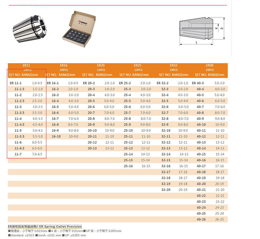

Do I need a different sized collet for a 0.25 inch surfacing cutter, other than the one that comes with the machine?
**Post date:** [March 23, 2021, 2:09am UTC](https://forum.snapmaker.com/t/some-info-on-cnc-tool-changes-and-combo-cnc-laser-projects/14102/22 "2021-03-23T02:09:47Z")
Depends on the size of the shank. If it’s not 3.175mm you will need a different sized er11 collet.
**Author:** ![dbvanhorn](https://avatars.discourse-cdn.com/v4/letter/d/58956e/32.png) [@dbvanhorn](https://forum.snapmaker.com/u/dbvanhorn)\
**Post date:** [March 23, 2021, 2:34am UTC](https://forum.snapmaker.com/t/some-info-on-cnc-tool-changes-and-combo-cnc-laser-projects/14102/23 "2021-03-23T02:34:23Z")
I’m confused…
I read this:
[https://support.snapmaker.com/hc/en-us/articles/360024544094-How-many-collets-are-included-with-the-ER11-clamping-system-](https://support.snapmaker.com/hc/en-us/articles/360024544094-How-many-collets-are-included-with-the-ER11-clamping-system-)
and ordered a wasteboard mill with 1/4 inch shaft. I assumed that “it” in the second sentence referred to the collet.
**Author:** ![bobby4718](https://sea2.discourse-cdn.com/flex022/user_avatar/forum.snapmaker.com/bobby4718/32/11627_2.png) [@bobby4718](https://forum.snapmaker.com/u/bobby4718)\
**Post date:** [March 23, 2021, 4:29am UTC](https://forum.snapmaker.com/t/some-info-on-cnc-tool-changes-and-combo-cnc-laser-projects/14102/24 "2021-03-23T04:29:08Z")
I believe that the 1/4 inch shaft will work if I remember from what I’ve tried. It might be a snug fit as it is the upper limit that the included collet can hold, but definitely give us an update when it arrives to expand the knowledge of the community!
**Post date:** [March 23, 2021, 5:10am UTC](https://forum.snapmaker.com/t/some-info-on-cnc-tool-changes-and-combo-cnc-laser-projects/14102/25 "2021-03-23T05:10:20Z")
The article is misleading. It only comes with a single collet as it says: 1/8" or 3.175mm.
Where it says:
> It supports a variety of carving and cutting bits with diameters ranging from 0.5mm (0.020 inches) to 6.35mm (0.250 inches).
It should say “With additional collets it will support a variety of carving and cutting bits with shank diameters ranging from 0.5mm (0.020 inches) to 6.35mm (0.250 inches).”
To use other sizes of bits you will need to purchase additional collets. You should never use one that is too loose or try to force one in that is too tight. Always insert the collet into the nut so it clicks in, before inserting the bit.
**Post date:** [March 23, 2021, 5:30am UTC](https://forum.snapmaker.com/t/some-info-on-cnc-tool-changes-and-combo-cnc-laser-projects/14102/26 "2021-03-23T05:30:49Z")
Ok, that’s what I suspected. No big deal, but rewording that would be a good idea.
**Author:** ![Edwin](https://sea2.discourse-cdn.com/flex022/user_avatar/forum.snapmaker.com/edwin/32/13481_2.png) [@Edwin](https://forum.snapmaker.com/u/Edwin)\
**Post date:** [March 25, 2021, 3:41am UTC](https://forum.snapmaker.com/t/some-info-on-cnc-tool-changes-and-combo-cnc-laser-projects/14102/27 "2021-03-25T03:41:36Z")
Thanks for the explanation from @sdj544 . You will need to purchase additional collets. As you can read the specs of the ER11 collet, you need to find the suitable substitutes within the range of. 0.5mm (0.020 inches) to 6.35mm (0.250 inches)
