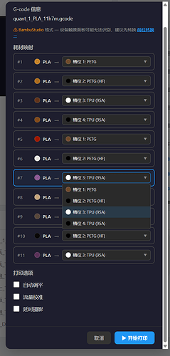

**Author:** ![monktangy](https://avatars.discourse-cdn.com/v4/letter/m/dbc845/32.png) [@monktangy](https://forum.snapmaker.com/u/monktangy)\
**Post date:** [June 30, 2026, 4:19am UTC](https://forum.snapmaker.com/t/snapmaker-u1-bambustudio/41966/25 "2026-06-30T04:19:58Z")
![image](https://us1.discourse-cdn.com/flex022/uploads/snapmaker/original/3X/c/5/c5231ee7f8fa038811cd6b4011db4d341b2706eb.png)
i am not sure why this code is still showing. i can upload and print from bambu studio, but i cannot manually click on it on the u1 side. it says unrecognised file and there is no print button.
added onto the problem i found out that is it doesnt seem to upload the filament selection in the gcode files. hence it couldnt print because it doesnt show up.
from the app it shows like this. that is probably the problem im facing right now. files uploaded into the gcode doesnt reflect any filaments required. hence the program stopped there.
 ![image](https://us1.discourse-cdn.com/flex022/uploads/snapmaker/original/3X/1/6/1668640db157cd4515e6093b6f6357c3dede9358.jpeg)
**Author:** ![VItasG](https://avatars.discourse-cdn.com/v4/letter/v/d78d45/32.png) [@VItasG](https://forum.snapmaker.com/u/VItasG)\
**Post date:** [July 1, 2026, 12:40am UTC](https://forum.snapmaker.com/t/snapmaker-u1-bambustudio/41966/26 "2026-07-01T00:40:19Z")
> [@monktangy](#):
> I can upload and print from Bambu Studio, but I can’t manually click it on the U1 end. The system prompts that the file cannot be recognized, and there is no print button.
1. Upload failure may be due to network issues or other reasons; sometimes gcode uploads fail. You can try uploading again. I will attempt to fix this.
2. Gcode cannot be recognized on the Orca/U1 device end: That is correct.
Currently, gcode generated by Bambu cannot be directly selected for printing on the U1 device side or in Orca. It can only be used within Bambu. Essentially, this is because Orca cannot recognize the identifiers within the gcode, preventing proper filament matching.
If you really want to use it on the device side, you can use the “Gcode Conversion” feature, which can convert Bambu’s gcode into Orca’s compatible mode.
Although I don’t think it’s very meaningful, you can give it a try. Be sure to check the gcode for any bugs.

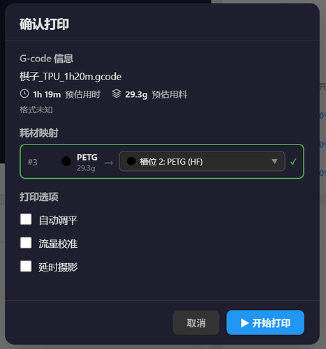

**Author:** ![jryan15](https://sea2.discourse-cdn.com/flex022/user_avatar/forum.snapmaker.com/jryan15/32/36683_2.png) [@jryan15](https://forum.snapmaker.com/u/jryan15)\
**Post date:** [October 7, 2026, 12:56am UTC](https://forum.snapmaker.com/t/snapmaker-u1-bambustudio/41966/40 "2026-10-07T00:56:46Z")
Hi all! Thank you so much for sharing this awesome project! It has already made a huge quality of life improvement for me!! I was hoping you could consider two issues. Maybe you have discussed them, but I did not see any comments in this thread.
1. The first item is that the gcode from Bambu does not trigger early pre-heating of the next nozzle swap and instead it waits until the current color is finished and then starts to heat the next nozzle. this causes the toolhead to sit and wait for a temp increase from 70c to 220c. The snapmaker will instead trigger a pre-heat command about 30 seconds before the end of the current color’s layer. It would be great if this dwell could be eliminated as a print with 1k tool changes might add 2-3hrs of wait time.
2. The second issue is if you have say 8 colors in your filament list and your print uses colors 2,4,6,8 when you go to the print confirmation on the device tab, it will only list the first 4 colors in the filament list with no obvisous method to change them. In this situation the colors for the unlisted #6 and #8 positions may not change the color correctly. Below are a couple images:
This slice uses colors 1, 4, 5, 6 but when i go to the confirmation screen, it will only list colors 1-4.
 ![image](https://us1.discourse-cdn.com/flex022/uploads/snapmaker/original/3X/d/5/d55f21e9821fc79e9918c9959c770a15ae747164.jpeg)
Please see how this confirmation screen shows the wrong colors that are not part of the model.
 ![image](https://us1.discourse-cdn.com/flex022/uploads/snapmaker/original/3X/8/e/8ee8938f5f6475a6f76dea7cce4d91e1e60dbdfa.jpeg)
Any thoughts, comments, or advice would be greatly appreciated.
Thanks!
**Post date:** [October 8, 2026, 12:22am UTC](https://forum.snapmaker.com/t/snapmaker-u1-bambustudio/41966/41 "2026-10-08T00:22:23Z")
First issue: Bambu does not generate the G-code for switching; this can only be resolved through subsequent G-code conversion or repair. The directly generated G-code cannot support preheating. This is likely a known issue, which I believe I have documented in the open-source files on GitHub.
Second issue: The second issue can potentially be fixed. This seems to be related to a mapping function.
I have attempted to fix the second issue: automatic G-code detection and recognition. The fix has been pushed to the main branch on GitHub. You can verify whether it has been resolved.
However, I had previously abandoned the main branch and have only been maintaining the remote branch. For convenience, I have merged both versions. You can download the latest version.
**Post date:** [October 9, 2026, 12:42am UTC](https://forum.snapmaker.com/t/snapmaker-u1-bambustudio/41966/42 "2026-10-09T00:42:03Z")
Thank you so much for digging deeper into this! I have also been working on issue 1 with some help from GPT and currently we have a modified bridge that can incorporate tool pre-heating. I am testing prints now to verify and so far it is working great. Will follow up soon. I don’t really know much about using branches and forks through gitnub, but will try to work it out :-).
Again, thank you so much for starting this amazing project!!
**Post date:** [October 9, 2026, 7:58am UTC](https://forum.snapmaker.com/t/snapmaker-u1-bambustudio/41966/43 "2026-10-09T07:58:34Z")
Thanks VitasGuo for putting this together! I’ve been using it and worked on a fork to add a few things I wanted:
- Automatic nozzle preheating so there is less waiting at color changes.
- Filament selection that only shows the colors actually used in the print
- All toolheads allow you to select any of the available filaments and there is no concern about the order. Your model could use filament numbers 2,5,8,9 and they can easily be mapped to tools 1-4.
- The ability to map more than one project color to the same toolhead. If your project uses more than 4 filaments, you can easily point the excess filaments to any of the 4 toolheads.
