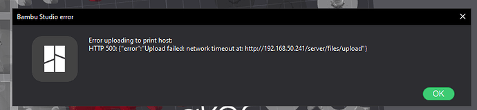

**Author:** ![monktangy](https://avatars.discourse-cdn.com/v4/letter/m/dbc845/32.png) [@monktangy](https://forum.snapmaker.com/u/monktangy)\
**Post date:** [June 26, 2026, 2:09pm UTC](https://forum.snapmaker.com/t/snapmaker-u1-bambustudio/41966/12 "2026-06-26T14:09:52Z")
![image](https://us1.discourse-cdn.com/flex022/uploads/snapmaker/original/3X/7/0/707efcdf34d2b522535aa1007d00ed1b1e5e4845.png)
hi vitas i tried it and to this point i have this error.

**Author:** ![VItasG](https://avatars.discourse-cdn.com/v4/letter/v/d78d45/32.png) [@VItasG](https://forum.snapmaker.com/u/VItasG)\
**Post date:** [June 26, 2026, 4:19pm UTC](https://forum.snapmaker.com/t/snapmaker-u1-bambustudio/41966/13 "2026-06-26T16:19:30Z")
This was caused by the bridge not starting correctly.
The solution provided by AI was to downgrade Node.js.
**Problem Analysis**
**Root Cause: Line 354 of `install.ps1` calls npm incorrectly**
Key code:
PowerShell
```auto
$npmCmd = (Get-Command npm -ErrorAction SilentlyContinue)
& $nodePath $npmCmd install --production
On **Node.js v26.4.0** , `Get-Command npm` resolved to `npm.ps1` (a PowerShell script) instead of the traditional `npm.cmd`. As a result, the actual command executed became:
Plain Text
```auto
C:\Program Files\nodejs\node.exe "C:\Program Files\nodejs\npm.ps1" install --production
Node.js attempted to parse `npm.ps1` **as a JavaScript file** , but the first line was PowerShell syntax: `Set-StrictMode -Version 'Latest'`. Naturally, this resulted in a `SyntaxError: Unexpected string`.
The npm dependencies were never successfully installed (the `node_modules` directory was empty). When Bridge started, it could not find dependencies like Express, and thus could not listen on the port.
## **Solutions (Choose One)**
### **Solution 1: Manually Install Dependencies (Fastest)**
Open PowerShell as an administrator and run:
PowerShell
```auto
cd "C:\Program Files\Bambu Studio\bridge"
npm.cmd install --production
Or use directly:
PowerShell
```auto
& "C:\Program Files\nodejs\npm.cmd" install --production
After installing the dependencies, Bridge will start normally.
### **Solution 2: Downgrade Node.js to LTS Version (Recommended)**
**Node.js v26 is an unconventional version released in October 2026** , with changes to how npm is packaged. It is recommended to uninstall v26.4.0 and install **Node.js v22 LTS** :
1. Uninstall the current Node.js v26.4.0
2. Download **Node.js v22 LTS** from [https://nodejs.org](https://nodejs.org/)
3. Re-run `install.bat`
### **Solution 3: Explicitly Call `npm.cmd`**
Call the cmd version of npm directly in PowerShell:
PowerShell
```auto
Executing this after switching to the installation directory is more reliable than `node npm.ps1`.
**One-sentence Root Cause** : On v26, `Get-Command npm` returns `npm.ps1`, and the script uses `node.exe` to execute the `.ps1` file. Node.js does not recognize PowerShell syntax and throws an error directly. Using `npm.cmd` (a batch wrapper) bypasses this issue.

 ![image](https://us1.discourse-cdn.com/flex022/uploads/snapmaker/original/3X/3/c/3cd219313468564140d0541276d82ac67e0f2aa5.png)
**Post date:** [June 28, 2026, 4:53pm UTC](https://forum.snapmaker.com/t/snapmaker-u1-bambustudio/41966/18 "2026-06-28T16:53:47Z")
yes i just double checked from the router the ip was wrong but very weird thing is that i can view it being online and etc. but only uploading and print files cant work
**Post date:** [June 28, 2026, 4:59pm UTC](https://forum.snapmaker.com/t/snapmaker-u1-bambustudio/41966/19 "2026-06-28T16:59:19Z")
basically what i was facing is that i can slice the file i can see the file converting the plate into U1 plate but i cant upload because the IP address was wrong by 1 number. it was suppose to send to 240 instead of 241. the weird thing is that the live view function works even though the ip was at the wrong address.
**Post date:** [June 28, 2026, 5:41pm UTC](https://forum.snapmaker.com/t/snapmaker-u1-bambustudio/41966/20 "2026-06-28T17:41:40Z")
The slicing feature does not rely on the device being connected.
A proper device connection is only required when data transfer or device operations are involved.
Feel free to report any bugs to me.
**Post date:** [June 29, 2026, 7:56am UTC](https://forum.snapmaker.com/t/snapmaker-u1-bambustudio/41966/21 "2026-06-29T07:56:37Z")
how do i get the bug to be fixed or able to key the ip address manually? im stuck at this part right now
