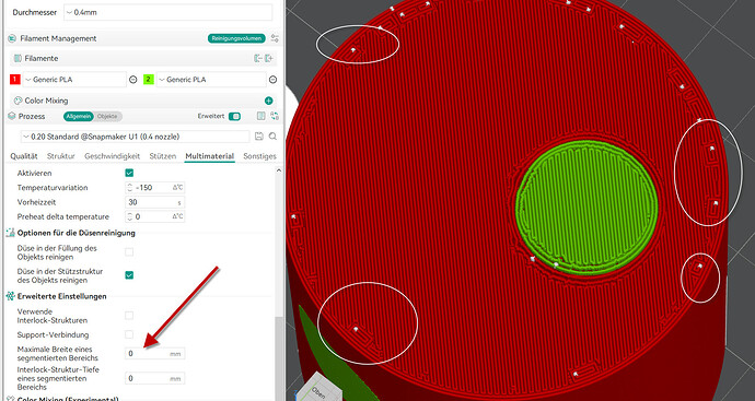

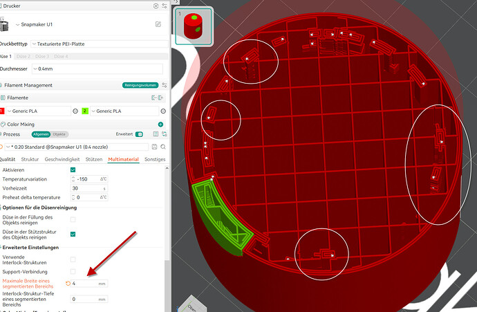

I encountered some strange error patterns in an object.
The setting was “Multimaterial \> Maximum width of a segmented area” = 2mm.
Strange internal structures were generated:
 ![Error1](https://us1.discourse-cdn.com/flex022/uploads/snapmaker/original/3X/b/1/b1742323c41a76f6f951efa4dbc79411a1665c67.jpeg)

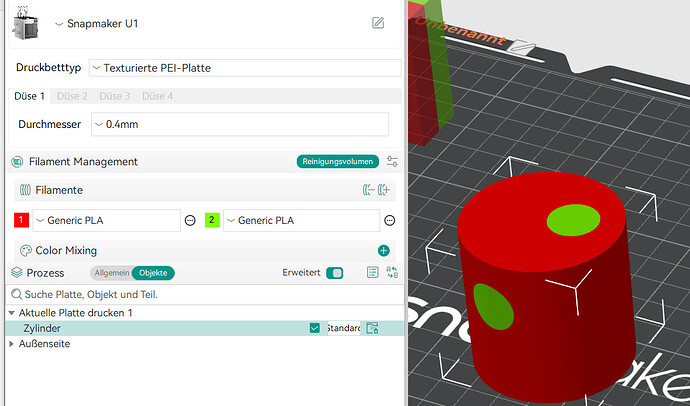

Initial setup for reproduction:
- Set base profiles to U1, print profiles to e.g. 0.2mm, and use 2 different generic color profiles.
- Add any cylinder, e.g., 50x50.
- Create 2 color blocks using the color function.
- Slice.
The malfunction during the generation of internal structures is clearly visible:
 ![Error_InitialSetup](https://us1.discourse-cdn.com/flex022/uploads/snapmaker/original/3X/f/2/f279e732c6a62a7bbbda091d093c0c56ff891835.jpeg)
 ![Error2](https://us1.discourse-cdn.com/flex022/uploads/snapmaker/original/3X/0/c/0ced50b1f23da89300ec727a4b423a3b758f9a34.jpeg)
 ![Error3](https://us1.discourse-cdn.com/flex022/uploads/snapmaker/original/3X/1/9/19c8b2c95410dd621d8dccd4847371cfbeb4b4aa.jpeg)

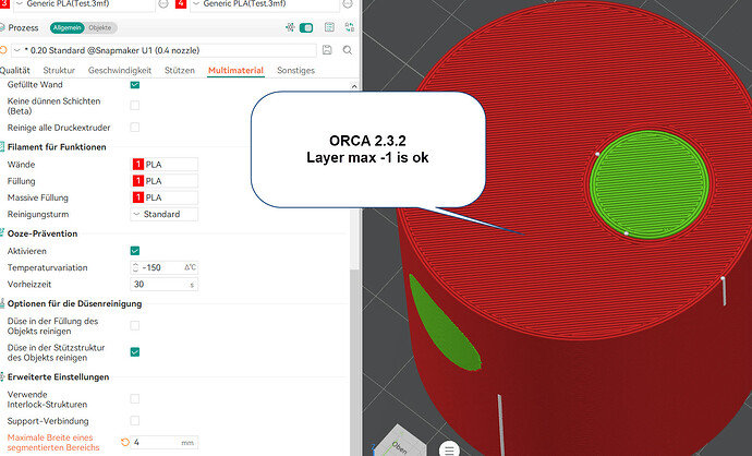

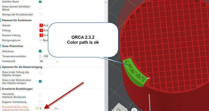

In my additionally installed original Orca version 2.3.2, this error cannot be reproduced.
Therefore, from my perspective, this is a bug in Snapmaker ORCA 2.3.3.

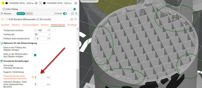

I’ve ran into multi-material support printing issue in SnOrca 2.3.3
> [@SnOrca v2.3.3 BUG? Multi-material support prime tower sticking issue](https://forum.snapmaker.com/t/snorca-v2-3-3-bug-multi-material-support-prime-tower-sticking-issue/42177):
> I’ve printed this model 7 times without issue. Now, PETG support keeps on failing to stay inside of the PLA prime tower. I’ve tried auto flow rate and bed level and gotten the same result. I can’t figure out what changed? Same file, same filaments. I also don’t get why PETG support only has one tiny spot on the 1st layer of prime tower

Here are images from the same project, slicing with ORCA 2.3.2
 ![ORCA.2.3.2.Bild1](https://us1.discourse-cdn.com/flex022/uploads/snapmaker/original/3X/1/4/1467098978c8bd561c182cb33bd256b1cd9d3a6d.jpeg)
 ![ORCA.2.3.2.Bild2](https://us1.discourse-cdn.com/flex022/uploads/snapmaker/original/3X/b/f/bfe2a0c766bd21b4f60cc07607445050648c6fbd.jpeg)
