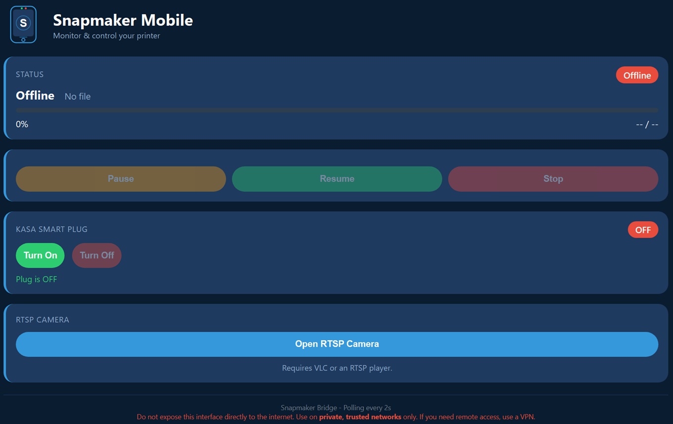

**Mobile Page**
A touch-friendly interface designed for smartphones. Check live status and progress, control Pause/Resume/Stop, toggle your Kasa plug, and open your RTSP camera feed-all from your phone. Server status on the tray menu automatically generates a QR code(s) that links to the mobile interface. Scan the QR code with your phone’s camera to quickly access the touch-friendly control panel without typing the URL manually.
