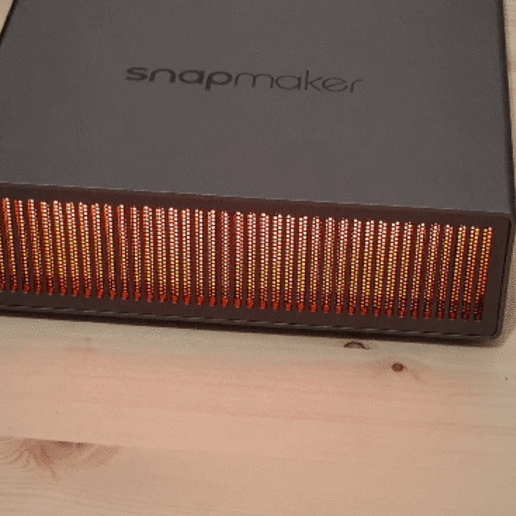

I agree, the standard white light is way too strong - but I have made a good solution for it, with a orange led diffuser. It works really well 🙂
> **[Snapmaker PSU LED Diffuser](https://cults3d.com/en/3d-model/various/snapmaker-psu-led-diffuser)**
> A 3d printed diffusor for the Snapmaker 2 PSU.
> The white LED are to bright for my liking, so here are a solution to dim the light and even give it some tint.
> I have used red transparent PLA from Colorfabb:
> https://colorfabb.com/red-transparent
> It...

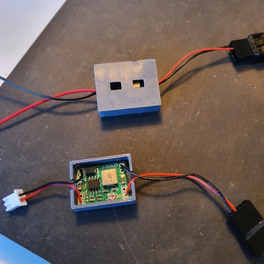

I have used a Noctua NF-A4x10 FLX with a buck converter, that works great. Now the PSU is not bothering my anymore.
For the exhaust fan I used a Noctua NF-A8 FLX. Its not pulling that much air at 12v, but very silent and efficient enough for my use.
You can look at my solution her:
> **[Step Down Module - Box](https://cults3d.com/en/3d-model/various/step-down-module-box)**
> This is a small box for a tiny stepdown module, which can be used to convert 24v to 12v.
> Perfect for a 3d printer fan upgrade.
> Used on my Snapmaker A350 for both the PSU fan and the exhaust on the enclosure. Making them very silent with Noctua 8cm...

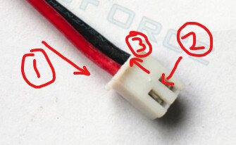

hello, just ordered this fan per your suggestion. how easy is it to switch polarity if they are reversed?
**Post date:** [December 10, 2020, 5:07am UTC](https://forum.snapmaker.com/t/sm2-power-module-noise/6129/112 "2020-12-10T05:07:38Z")
The connectors have a small hook inside you need to depress (sometimes rather forcefully) to remove. Something pointy works best, I usually use a pair of tweezers that are pointy at the end.
 ![image](https://us1.discourse-cdn.com/flex022/uploads/snapmaker/original/2X/1/1f1391c43b76a4f94548594e72aec91de28f0bd2.png)
Also, it was surprisingly difficult to find an image of the hook.
You won’t really be able to see the hook because it’s small, but if you 1) push the wire into the connector to relieve pressure on the hook, then 2) jam the tool in and down to depress the hook and 3) push out hopefully it’ll remove from the housing after a few tries.

**Author:** ![crysvan01](https://sea2.discourse-cdn.com/flex022/user_avatar/forum.snapmaker.com/crysvan01/32/8677_2.png) [@crysvan01](https://forum.snapmaker.com/u/crysvan01)\
**Post date:** [December 10, 2020, 5:47pm UTC](https://forum.snapmaker.com/t/sm2-power-module-noise/6129/113 "2020-12-10T17:47:19Z")
Thank you so much! This is very helpful. I originally ordered a different fan that was suggested in the fb group but those didn’t have connectors already and I didn’t really want to cut and splice the connectors in the original fan lol (haven’t really done this before so I’m a little hesitant) but this one makes it so much easier 🙂
**Post date:** [December 10, 2020, 6:14pm UTC](https://forum.snapmaker.com/t/sm2-power-module-noise/6129/114 "2020-12-10T18:14:40Z")
> [@brent113](#):
Got it. Stubborn ass little hooks
**Post date:** [December 10, 2020, 6:28pm UTC](https://forum.snapmaker.com/t/sm2-power-module-noise/6129/115 "2020-12-10T18:28:34Z")
Is the polarity on the snapmaker module itself backwards? Because the original red pin does need + and original black pin does need -
i got it rigged up to a lil cable and 24 v source, lil bugger can blow some air!
I’m just asking because I wonder if the particular fan i received is wired differently than yours was.
I guess I will figure it out when I get home one way or the other though!

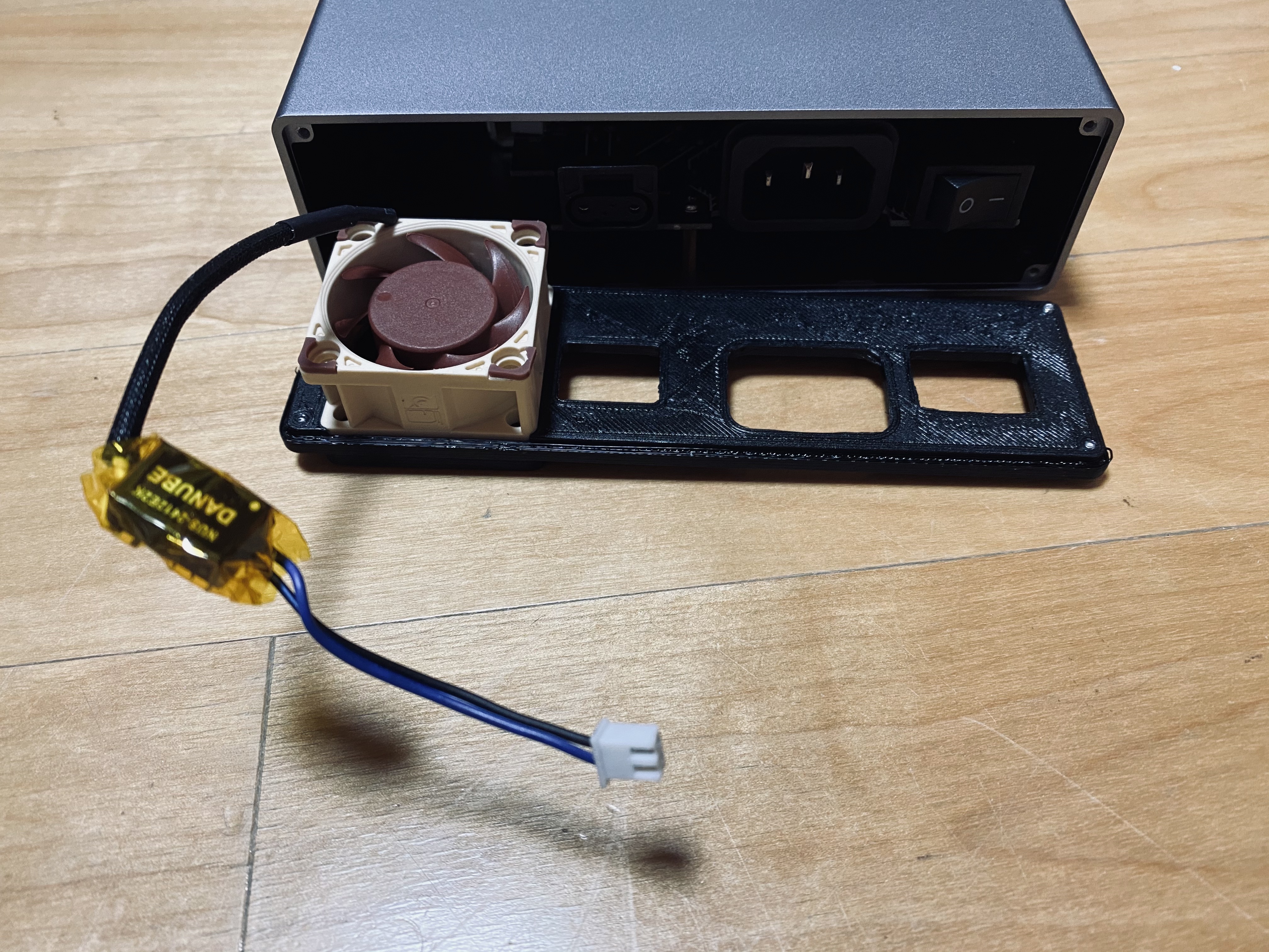

Received my Snapmaker last week and after the first power up I was suprised how ridiculously loud the PSU is. Also designed (yet another) fan bracket for the exhaust fan without the need of modificating the back plate. Thought I might share with you::
> **[Snapmaker 2.0 PSU Fan Bracket by Andomaster](https://www.thingiverse.com/thing:4694528)**
> Hi all,
> as the Snapmaker 2.0 PSU is known to be quite noisy I was looking for ways to quiet it down a bit.
> Since most of the existing mods require either modification of the original back plate or need a whole new printed backplate I was thinking of...
Also made a short video for comparison of the stock fan to a Noctua fan if someone who hasn’t received the Snapmaker is wondering what everybody is talking about… 😅
> **[Meet Google Drive – One place for all your files](https://accounts.google.com/ServiceLogin?service=wise&passive=1209600&continue=https:%2F%2Fdrive.google.com%2Ffile%2Fd%2F15lRznukWRy1383jZLVByTgur2sw1mwkv%2Fview?usp%3Dsharing&followup=https:%2F%2Fdrive.google.com%2Ffile%2Fd%2F15lRznukWRy1383jZLVByTgur2sw1mwkv%2Fview?usp%3Dsharing)**
After silencing the exhaust the PSU wasn’t as quiet as expected so I took a closer look at the power supply. Installed is a 350W “Great Wall” PSU, the venting holes made quite some whistling noise.
First i thought of printing a new cover but since it is a low profile PSU without much room to the top of the enclosure I wouldn’t be very comfortable with a (thermo)plastic cover so close to heat sources.
So instead I removed this venting hole part completely and sanded the edges down.
 ![20201222_110301_HDR](https://us1.discourse-cdn.com/flex022/uploads/snapmaker/original/2X/3/334586ad82008cf5c7e6cdcd9b2e4234f32f6ad7.jpeg)
 ![20201222_110316_HDR](https://us1.discourse-cdn.com/flex022/uploads/snapmaker/original/2X/0/0a498e79ae45272517abb8c754e563cb462d48a7.jpeg)
Now the whistling noise is gone but still have to replace the integrated fan to quiet it down to a reasonable sound level.
