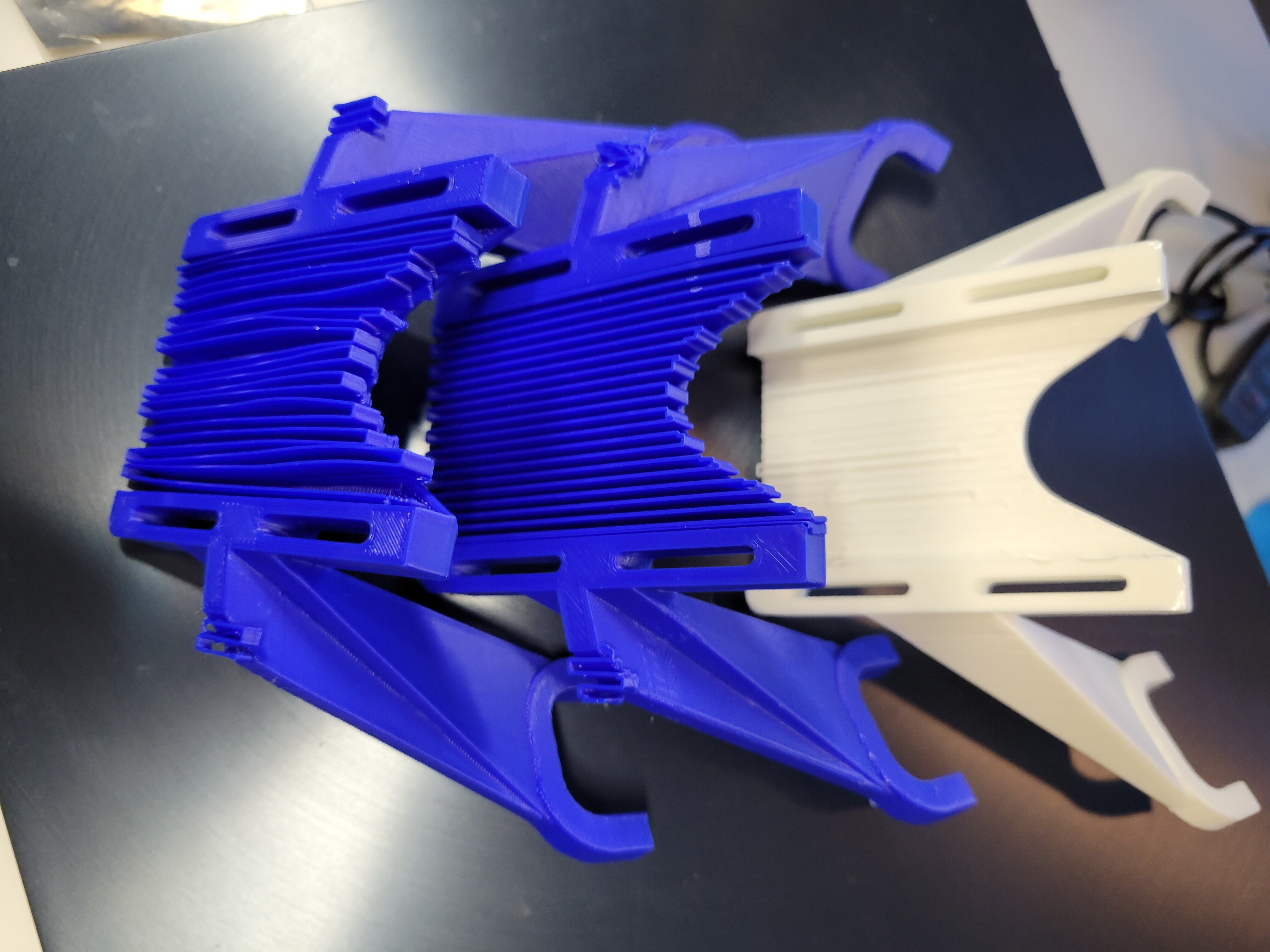

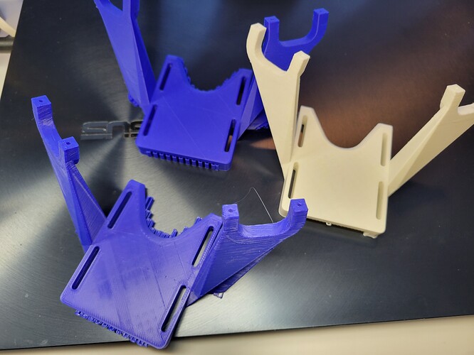

This is a test s3d factory file I created over the past week. I have run 10 plus parts and got it right after the first 2. This is for 4.1.2 testing 5.01 now. The only issue I had was getting z set. I found 10.812 worked best on all my tests using Hatchbox PLA . The supplied PLA seemed more gummy and difficult to remove then Hatchbox. I use bed at 65 and extruder at 210 . I also only print on the glass smooth side of table. I have been doing that for two years with my old IDEX, no real problems with breaking loose during run when set correctly.

I used the factory file from my other IDEX printer which has been running S3D for two years now. I just cleared STL files out and saved it without any part in it. That’s the file I sent the link for. You should be able to load it as a blank part and add your test part and tweak. Made about 8 good parts no issue. I just ran the S3D version 5 today and it seems to work fine. The supports are wrapping a little not important they are coming off.
