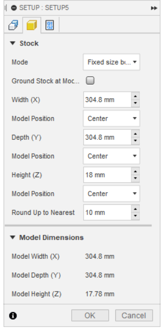

Settings for set up are as follows. Still trying to figure out how to get subsequent passes to pick up where the previous pass left off (relative to the Z axis)
 ![image](https://us1.discourse-cdn.com/flex022/uploads/snapmaker/original/3X/9/b/9bf1703ea2e2faa6942d8d555614f613cc9b19f3.png)
 ![image](https://us1.discourse-cdn.com/flex022/uploads/snapmaker/original/3X/9/5/958e2bfd0e77dabc19fd9d173e77509f3c21252c.png)
 ![image](https://us1.discourse-cdn.com/flex022/uploads/snapmaker/original/3X/b/f/bf002bda741b1c1d2401ef386473871ff89714a2.png)

You don’t have a machine selected. If you have the SM config file for Fusion installed you should be able to select your machine.
I’d turn off the “round up to nearest”. Fusion is designed for pro use and most cnc businesses use preset stock sizes so that’s why that’s there.
Is your stock size your actual stock size that you entered? Or is that the size of your model?

Have I interpreted it to suggest that by setting a work origin (that doesn’t get milled in any of the passes, then adjusting the Z (only) to compensate for the different lengths in bits, that Fusion 360 subsequent passes will actually pick up where the previous toolpath left off?
Do you have any that show how to set up the Snapmaker 2.0 profile in Fusion 360?
**Post date:** [December 19, 2021, 6:09pm UTC](https://forum.snapmaker.com/t/roughing-pass-finishing-pass-what-am-i-doing-wrong/22741/24 "2021-12-19T18:09:50Z")
As long as you don’t accidentally change the x or y, then yes. Take a picture of work origin on touchscreen in case you mess it up.
And as long as your settings are correct for heights and rest machining and consistent between your toolpaths. If you change something under setup (stock size, work origin etc) you need to redo all your toolpaths.

Rest machining is a setting that accounts for the roughing material loss, and starts where the previous tool ended.
**Author:** ![disparatic](https://avatars.discourse-cdn.com/v4/letter/d/eada6e/32.png) [@disparatic](https://forum.snapmaker.com/u/disparatic)\
**Post date:** [December 20, 2021, 4:23pm UTC](https://forum.snapmaker.com/t/roughing-pass-finishing-pass-what-am-i-doing-wrong/22741/27 "2021-12-20T16:23:50Z")
Thanks BluegrassBlaster - how do you set it to pick up (with the lower Z) where the rough pass removed the stock wood? Why would mine have been hovering around in the air instead of dropping to the appropriate Z coordinate & picking up where the rough pass left off?
**Post date:** [December 20, 2021, 6:33pm UTC](https://forum.snapmaker.com/t/roughing-pass-finishing-pass-what-am-i-doing-wrong/22741/28 "2021-12-20T18:33:18Z")
With rest machining turned on, on subsequent passes it should start off where the last pass left off.
Share your Fusion project and we can take a look.

**Post date:** [December 20, 2021, 6:55pm UTC](https://forum.snapmaker.com/t/roughing-pass-finishing-pass-what-am-i-doing-wrong/22741/30 "2021-12-20T18:55:14Z")
Yea, looks mostly fine. And since I can’t actually look at the toolpath preview it’s going to be looking for a needle in a haystack to try and figure out what went wrong.
Without posting the file I’d suggest playing through the toolpath previews in f360 to try and identify where the issue lies.
I agree with what was suggested earlier, something about your fusion origin doesn’t match what you’re entering when you start the job. Or some spurious setting somewhere is causing an issue that is harder to troubleshoot than looking through screenshots of about a hundred settings.
If I had to guess stock rounding is still the issue, as Steve mentione earlier here:
> [@Roughing Pass & Finishing Pass (what am I doing wrong)](https://forum.snapmaker.com/t/roughing-pass-finishing-pass-what-am-i-doing-wrong/22741/22):
> You don’t have a machine selected. If you have the SM config file for Fusion installed you should be able to select your machine. I’d turn off the “round up to nearest”. Fusion is designed for pro use and most cnc businesses use preset stock sizes so that’s why that’s there. Is your stock size your actual stock size that you entered? Or is that the size of your model? Have you read this thread: [https://forum.snapmaker.com/t/some-info-on-cnc-tool-changes-and-combo-cnc-laser-projects](https://forum.snapmaker.com/t/some-info-on-cnc-tool-changes-and-combo-cnc-laser-projects) -S
Would easily explain about ~2.2 mm of the offset and you didn’t respond confirming you made a change based on that.
