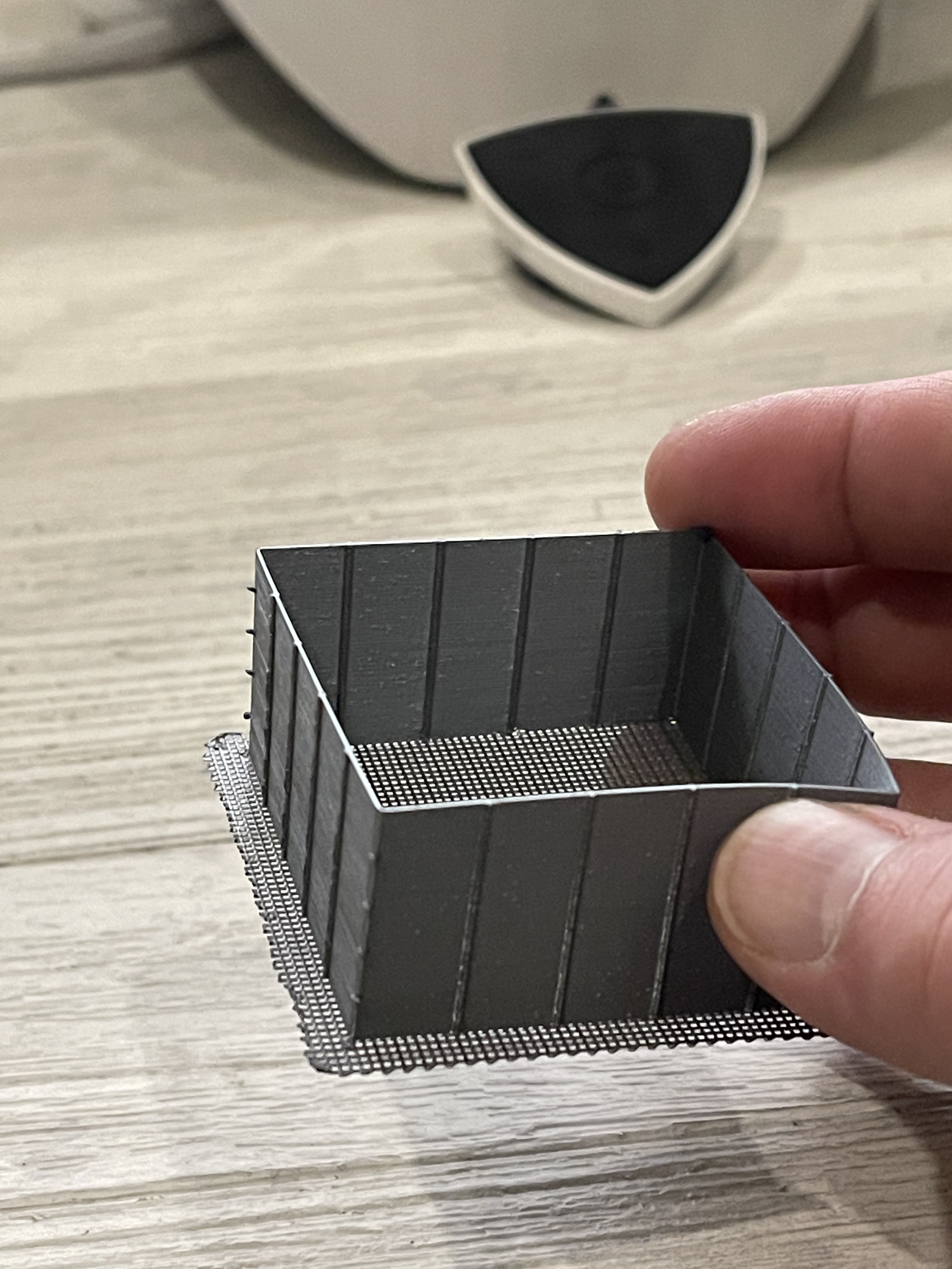

![IMG_3650](https://us1.discourse-cdn.com/flex022/uploads/snapmaker/original/2X/1/14798913b047129da105d7868b0f627f1e126ce0.jpeg)
This is an example of the later stages, where I have discovered clean retraction settings. It can be pretty ugly in the earlier “guessing” stages.

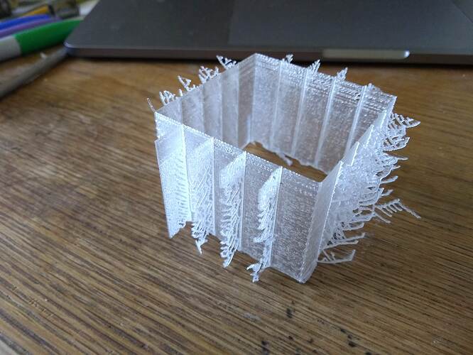

 ![IMG_20210416_135021885](https://us1.discourse-cdn.com/flex022/uploads/snapmaker/original/2X/f/f2a2c085408b0460b972045c30ab21da324d9953.jpeg)
In the GCode, it gives a summary of the results (along with all the inputs [not included]):

The left corner is the origin.
I don’t really know how to interpret this. I _think_ this is telling me that my nozzle temp is too high, because none of the variables gave me a clean travel. On my temp tower, 180 actually looked the best, but it requires more force to push filament through when I’m loading. 190 was almost as good as 180, but with the same amount of force required as 200 and 210. So I went with 190.
I do think it’s odd that the top layers, with the fastest retraction speed, have the most dense ooze sculptures.
**Author:** ![untergeek](https://sea2.discourse-cdn.com/flex022/user_avatar/forum.snapmaker.com/untergeek/32/11153_2.png) [@untergeek](https://forum.snapmaker.com/u/untergeek)\
**Post date:** [April 16, 2021, 9:10pm UTC](https://forum.snapmaker.com/t/retraction-calibration-tool/17894/10 "2021-04-16T21:10:56Z")
I’d be happy to give you the _range_ I ended up using for my last test print. I was frankly stunned when I discovered how slow I have to retract in order to get clean PETG prints. I haven’t tried this with PLA yet, so I do not yet have any data in that area. This would be a great place to share that.
The defaults are okay, I suppose, but I saw better results when using the lower speeds of a direct drive feed, rather than Bowden tube.
```auto
Start Retraction Distance: 3.1
Increment Retraction: 0.1
```auto
Start Retraction Speed: 2.8
```auto
Layer height: 0.2
I did successful tests with 0.2 and 0.16—I prefer the output of 0.2 better, and it’s stronger, even though the layers are a tiny bit smoother with 0.16.
```auto
Start Temp: 242
Increment Temp: 0
This will vary with your material’s particular melting points. I used Overture PETG, which officially has a range of 230 - 250 °C. I had success between 238 and 242. PETG gets stringier the warmer it is, and layers do not adhere as well if it’s too cool.
```auto
Fan Speed: 80
Fan Increment: 0
There’s no bridging here, and the stock fan doesn’t throw a ton of air, so this worked out well for me.
```auto
Layers per test: 25
Number of tests: 4
I found that the walls warped a bit the taller it got. 10 to 15 was just too many, and ended up wasting time when I was close. As always, your mileage may vary.
```auto
Travel Speed: 150
Print Speed: 40
Faster travel seems to help reduce stringing, and the `40` print speed is within reason.
I consistently found (for myself, _with PETG_) that 4.2 - 4.3 retraction distance and 2.9 retraction speed were the cleanest. It’s astonishingly slow, but it was clean.
