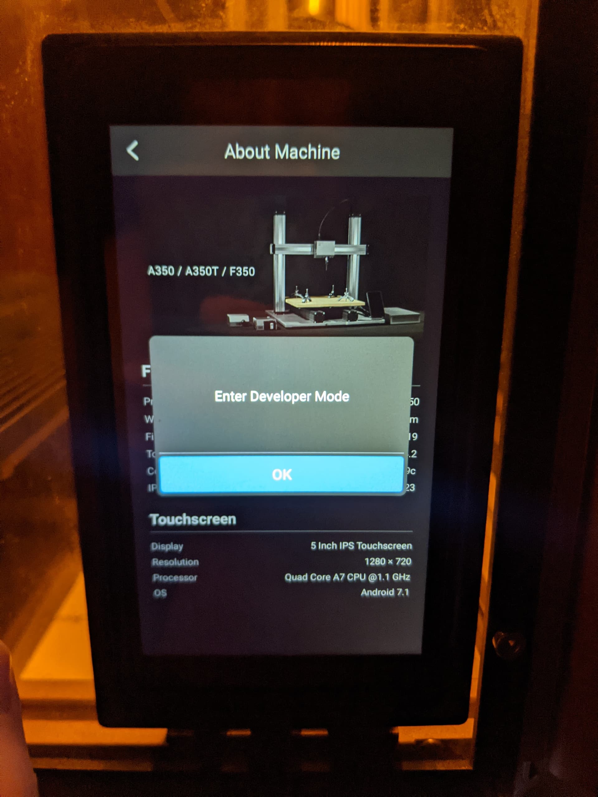

**Post date:** [November 18, 2022, 2:34am UTC](https://forum.snapmaker.com/t/remove-firmware/27905/4 "2022-11-18T02:34:48Z")
When you tap the picture of the machine 5 times, you should get this popup;
 ![PXL_20221118_023158605](https://us1.discourse-cdn.com/flex022/uploads/snapmaker/original/3X/4/8/484e280c507754c703cd4e10efd0fbe3c16a6ec5.jpeg)
After you tap `OK` tap the back arrow at the top of the screen, you’ll have two new icons in the apps.
 ![PXL_20221118_023212800](https://us1.discourse-cdn.com/flex022/uploads/snapmaker/original/3X/4/5/450da32ba776518a7864ae8307be617c9cd635bb.jpeg)

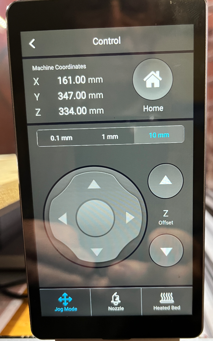

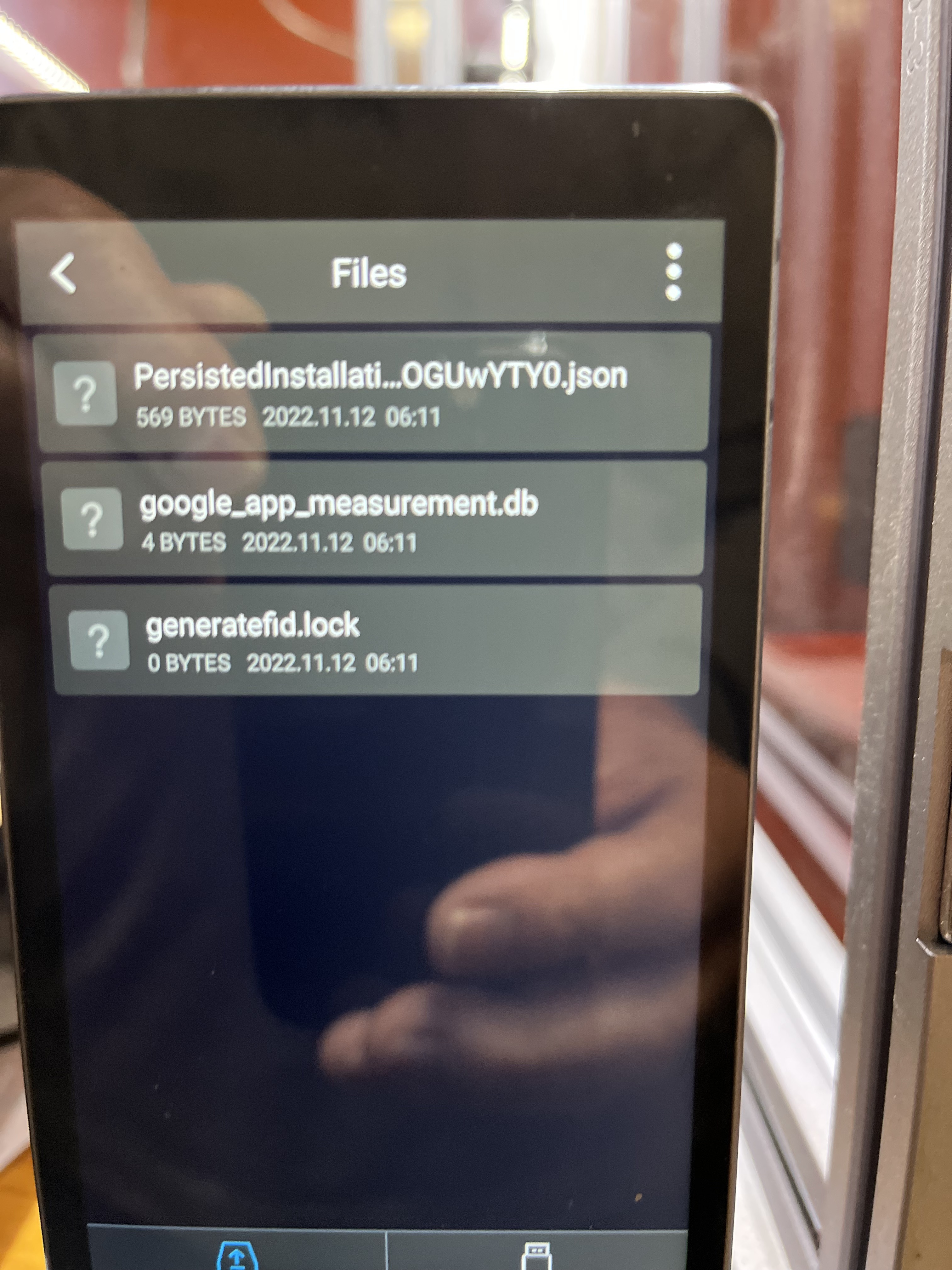

**Author:** ![timsco60](https://avatars.discourse-cdn.com/v4/letter/t/c6cbf5/32.png) [@timsco60](https://forum.snapmaker.com/u/timsco60)\
**Post date:** [November 18, 2022, 8:21pm UTC](https://forum.snapmaker.com/t/remove-firmware/27905/10 "2022-11-18T20:21:34Z")
There is something serious wrong with my Snapmaker. I have done everything you asked and the problem will not go away. I think something might have happened to the main board. Why I say this first the low power laser goes on and off and stays on when upgrading and remains on. Second when trying the CNC (see control screen picture) I never had this screen before when cutting. I see see any files in my USB.
Why and what are the files folder (see files picture), I never had this before until I upgraded to V1.14.3 .
Can I get parts from Snapmaker to correct this or is there another way to fix this? I had someone reply to this post and mentioned I have an expensive brick which I feel was uncalled for. I like my Snapmaker since I got it as a Kickstarter and haven’t any problems until this happened.

Unusual indeed, can you try downgrading to 1.13.2 and see if anything changes?

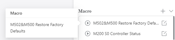

**Post date:** [November 18, 2022, 11:39pm UTC](https://forum.snapmaker.com/t/remove-firmware/27905/13 "2022-11-18T23:39:44Z")
Alright, seems to be in the controller. Try resetting it by connecting via USB to your PC. Open Luban and connect via serial. In the terminal at the left type `M502` (must be capital M) then update your firmware and modules.
EDIT: There’s actually a macro built into Luban to do this apparently.
![Screenshot 2022-11-19 075136](https://us1.discourse-cdn.com/flex022/uploads/snapmaker/original/3X/a/d/ad68d7c6ddbd740ccd5d4bd28b22508dc9f45f35.png)

**Post date:** [November 19, 2022, 2:50pm UTC](https://forum.snapmaker.com/t/remove-firmware/27905/16 "2022-11-19T14:50:41Z")
I don’t have a mac, but the connection to the snapmaker should be the same. If your snapmaker is connected to wifi, it should be listed on the left in Luban. Click connect and then accept on the touchscreen to connect. You can then use the macro command on the right, just click the play button.
You can also run a USB from your computer to the microUSB port on the side of the controller (should be above the standard USB), swap to “serial” in the connection box, and it’ll be listed there.

**Post date:** [November 19, 2022, 4:33pm UTC](https://forum.snapmaker.com/t/remove-firmware/27905/18 "2022-11-19T16:33:03Z")
Send an `M500` command, then reboot the machine.

**Post date:** [November 19, 2022, 5:01pm UTC](https://forum.snapmaker.com/t/remove-firmware/27905/20 "2022-11-19T17:01:05Z")
After sending `M502` and `M500` together, followed by a reboot, the main controller should have been reset. With the CNC module attached, try installing firmware version 1.13.2 and see if it recognizes it as the CNC module. Also make sure the heatbed isn’t plugged in (I assume it isn’t).
Also on the main screen, does it show “CNC” with a green dot?
