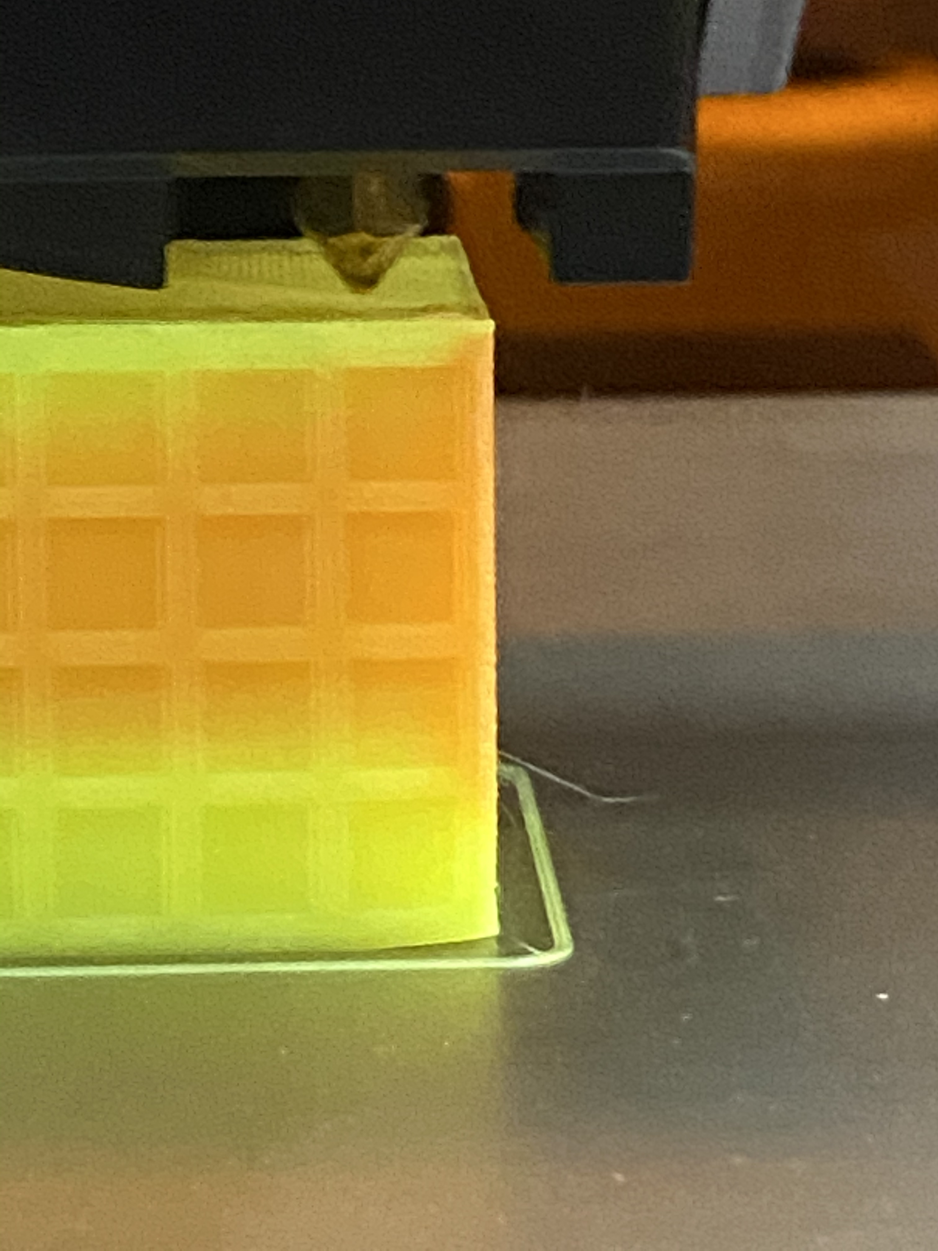

Ok I got the metal bed almost perfectly leveled. Changed filament to a heat color changing filament so I could see if it was cooling anywhere.
I rechecked the esteps, ran another temperature tower, ran another retraction tower and did k value for the first time.
It came out a lot better. 200/70 - however still have some elephant foot on the right side. I’ve calibrated the bed enough times that I touch the bed often when it’s 70. I was touching it while it was printing and it felt much hotter. Once I dig out my husbands heat sensor I’m going to double check the bed. I turned on an external fan on at the top layer right before bridging (no layer separations) - next time I’ll turn it on after the first few layers and see if I can get it a little smoother. I’m also going to lower the bed temperature significantly as well to see if that helps with the elephant foot. I also think I’ll turn the fan on high when it’s creating the bridge as I had a small dip on each side.

Wow, that’s a cool filament, and smart using that to look for temperature differentials. If you feel like trying a new slicer, cura has a setting that you can use to try to reduce elephant’s foot (so do other slicers but I only have experience with cura). Unfortunately Luban does not, but that makes sense as it’s intended as a jumping off point for those just getting started. You can also check out [this youtube video](https://youtu.be/zlgR3rHg4p8) from Maker’s Muse for other methods of dealing with elephant’s foot as well.
I would be careful with lowering the bed temperature too much as that can make the first layer not adhere as well.
As mentioned before, turning that model on its side would mean that you don’t have to do bridging at all, but it seems like you have managed to calibrate well enough that bridges print well which is good.

Yes I plan on trying that next as well - I didn’t want to change too many things at once. This way I can narrow down the issues.
I do have Cura downloaded - I just need to dig in and try it. However I thought I’d start with simple Luban first to get the basics down.
I’ll update if I discover any other things causing my issues.
