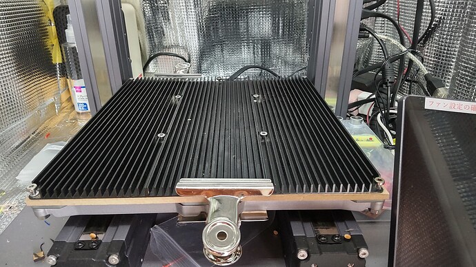

I made a bed for a laser.
 ![DSC_0110](https://us1.discourse-cdn.com/flex022/uploads/snapmaker/original/3X/b/d/bddda90b2df8719e75fd33fcd18c86634c1bbaa8.jpeg)
A 5mm MDF board was cut to bed size and double-sided tape was applied.
 ![DSC_0112](https://us1.discourse-cdn.com/flex022/uploads/snapmaker/original/3X/7/f/7f3bd536cf4e15237bfe82481149d99389f54e6a.jpeg)
A cutting platform was attached on top of it. Bolts are attached to block the holes.
 ![DSC_0111](https://us1.discourse-cdn.com/flex022/uploads/snapmaker/original/3X/2/0/20da0223d69ea347f22570631288451ae54bc147.jpeg)
The heat bed is not removed. I placed the board I created on top of it and secured it with clips.
I don’t use CNC, so this is enough about beds.I hope a quick swap for the head will be available soon.

There’s lots of examples out there. They work well; just takes a clip or clamps to hold them in place since there isn’t much toque applied to them. Even CNC I havne’t had issues just clamping them (c clamps) to the heated bed.

I am surprised that CNC is not a problem.
Just eliminating the hassle of changing beds has made it much more convenient. I frequently switch between 3DP and laser to work with it. I hope you will sell attachments for the head soon.
