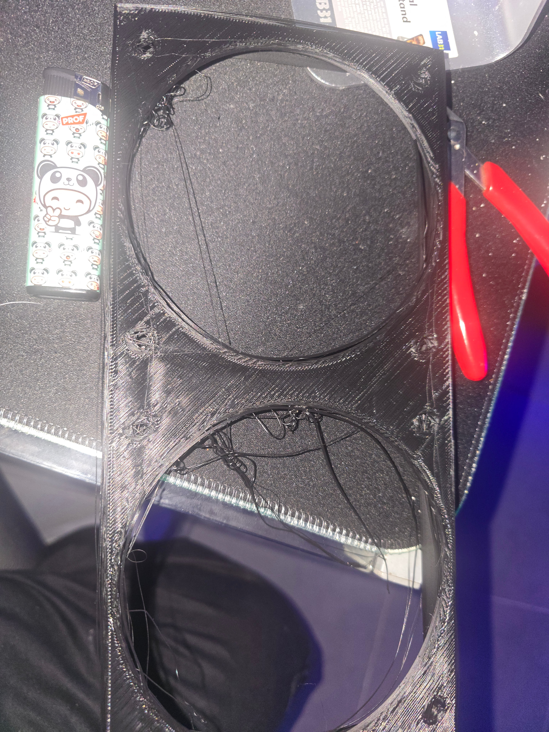

Hello everyone,
As I explained in my presentation, I am a beginner in 3D printing. I have tried several prints, and everything prints correctly except for the engraving, which does not stick to the bed and ends up moving. I have cleaned the bed and adjusted the temperatures, but nothing works. If someone could help me, I would appreciate it.
Thank you in advance.

Sharing pictures would help.
Try to lower your z-offset on the touchscreen while printing the first layer.

for the z-offset I slide a sheet for calibration

your z offset very far from being tuned, use something like this [https://www.thingiverse.com/thing:5387638](https://www.thingiverse.com/thing:5387638), print it, while it prints decrease z offset until filament will be pushed to print bed enough to no gaps between lines and not too much to make waves.

yesterday I was checking my bed level, took it from my waste box so it’s a bit deformed but you may see that squares more or less equal in thickness and thin lines not separated from each other.
 ![photo_2026-03-17_23-04-58](https://us1.discourse-cdn.com/flex022/uploads/snapmaker/original/3X/c/b/cbd5c14e6583b547f3c005f57edac35fce93fc4d.jpeg)
If z offset not let you get all the squares be good enough you may need to work on flatness of your heated bed.

Decrease your z Level. You are still too far away from the bed.
