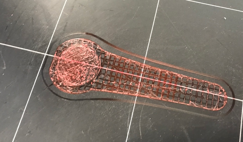

Also trying to print TPU on my A350. This is Overture brand filament. I did not bake it, but it came fresh out of a vacuum pack with dessicant. I never heard any sizzling which would indicate there was humidity in the filament. I started with slow speed 20 mm/s for all speeds. I experimented with feeding filament from the Load screen at different temperatures and it seemed like the TPU started bunching up in the head (after the pinch/gear, before going into the hot end) until I raised the temp to 245. Seems high, but I figured everyone is different. Oh yeah, zero retraction and 100% flow.
The result is attached. It didnā€™t look great, but it was printing. The round portion was fully in contact with the build plate (on the left side of the image). Note this particular item required support along the long end of the print (to the right). After a while, it was just printing ā€œin airā€ and the filament was bunched up in the head again, not extruding.
What am I doing wrong?
20 mm/s may not be slow enough for TPU for the first layer. Iā€™d try 10.
It also looks to be calibrated too low but I canā€™t tell. Did you try measuring the thickness of the skirt?
That can give you some true feedback on your Z height.
I do tend to favor more squish on the first layer. Is that a problem with TPU?

Only if your printing too fast. :slight_smile: Because it doesnā€™t get the same kind of grip at the gear it can slip if itā€™s not free enough to come out the nozzle. Having the first layer be thicker than the others lets it adapt to the changes in Z offset from an uneven bed. I usually try to get ā€œmore squishā€ by upping the first layer percentage. I think its easier to moderate that vs the Z height/first layer thickness. If youā€™re getting good adhesion to the bed you can back off on the Z height.
Thanks for the tips. I will try a looser calibration. One comment though about the slippage: I donā€™t think my problem is the TPU slipping. When I open the filament hatch, I can see the filament is buckled between the gear and the hole entering the hot end. This implies to me that it didnā€™t slip, it just couldnā€™t take the pressure the filament driver was trying to deliver. I can see how slowing down would help and so would a looser first layer as both should reduce the required flow and thus pressure in the filament driver.

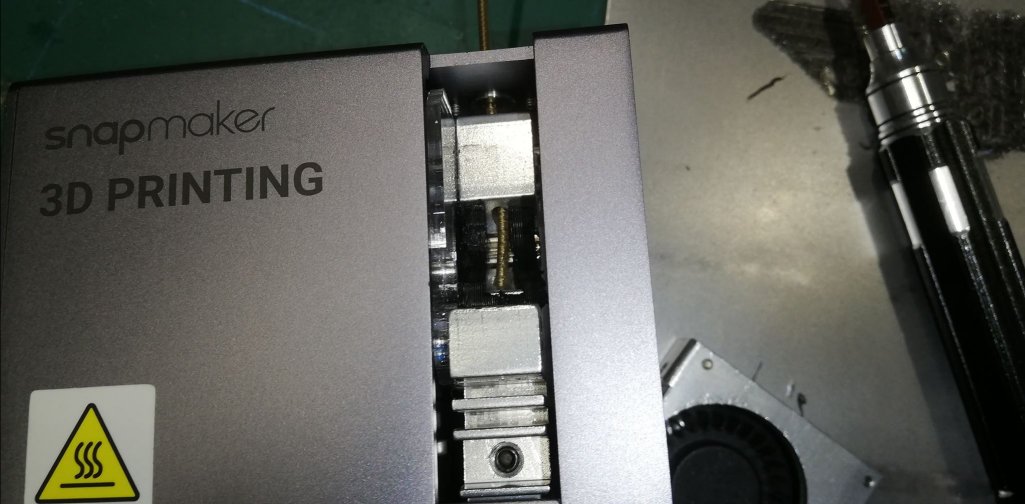

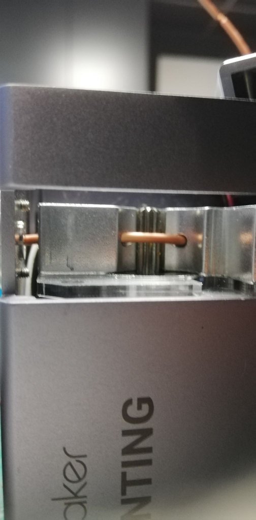

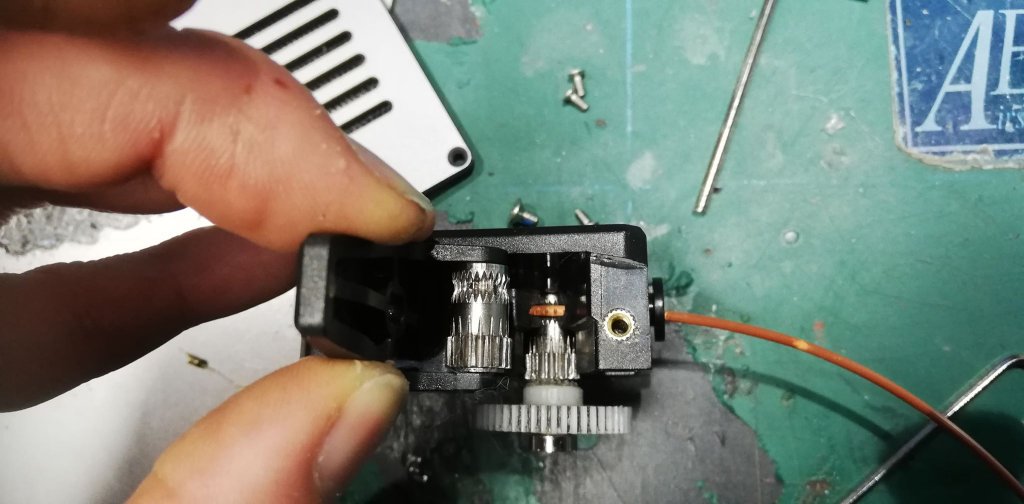

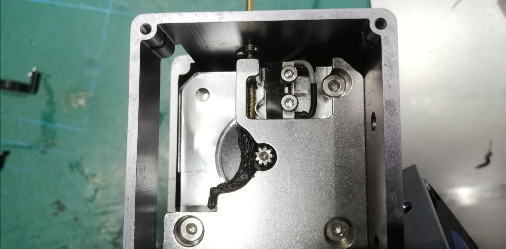

TPU is always going to be problematic with the current feed path design. Its the first thing i looked at when I opened the 3D printer head flap. The filament path is not constrained enough for flex filaments and combined with a flat tooth gear rather than a hobbed extruded gear its always gonna have problems like the filament wandering and jamming up inside.
Contrast that with a dual drive BMG type arrangement with dual hobbed gears and you can print TPU at 30-40mm/s without issue. I will look at at least replacing the drive gear with a hobbed gear which should be doable and that might improve things a bit

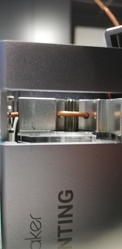

First 2 pics are a dual drive gear BMG clone. 2nd pics are the snapmaker extruder gear. See the difference. Unfortunatle snapmaker uses a proprietary very slim drive gearā€¦ so not an easy swap
Might be able to 3d print a small plastic piece that could be glued to the filament guide to close the gap and stop filament wanderingā€¦ This might do it

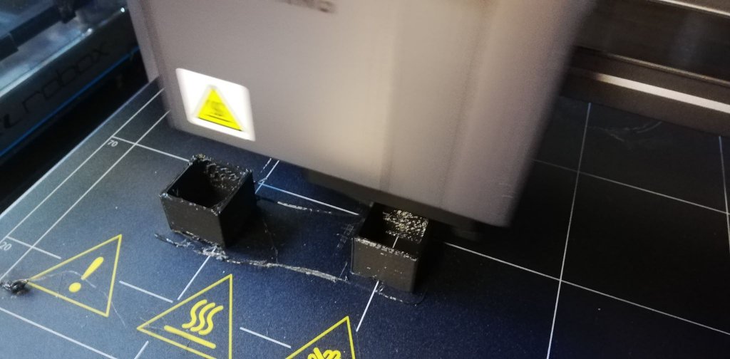

So yup after putting is an optimised insert into the print head to constrain wandering flex filament + a slightly stronger spring. happily printitng TPU at 40mm/sec with retraction. TPU is bioflex which is 27Shore D hardness or around 75A as most other filaments are measured in.
This is the modification:
2 test cubes printed all at once mode so lots of retractions, using CURA 4.2 at 40mm/sec . Am sure flow setting could be tuned a bit. Outer wall printed at 30mm/s
inner wall printed at 40mm/sec hence it a little rough
