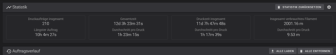

**Author:** ![Kalle\_BMW1](https://avatars.discourse-cdn.com/v4/letter/k/e99b99/32.png) [@Kalle\_BMW1](https://forum.snapmaker.com/u/Kalle_BMW1)\
**Post date:** [March 18, 2026, 11:57am UTC](https://forum.snapmaker.com/t/print-hours/41386/6 "2026-03-18T11:57:08Z")
![image](https://us1.discourse-cdn.com/flex022/uploads/snapmaker/original/3X/8/1/81d83d235ff0cd238d5d561c861f3102ade5df3d.png)
In the Klipper / Fluiid web view, you can see statistics
