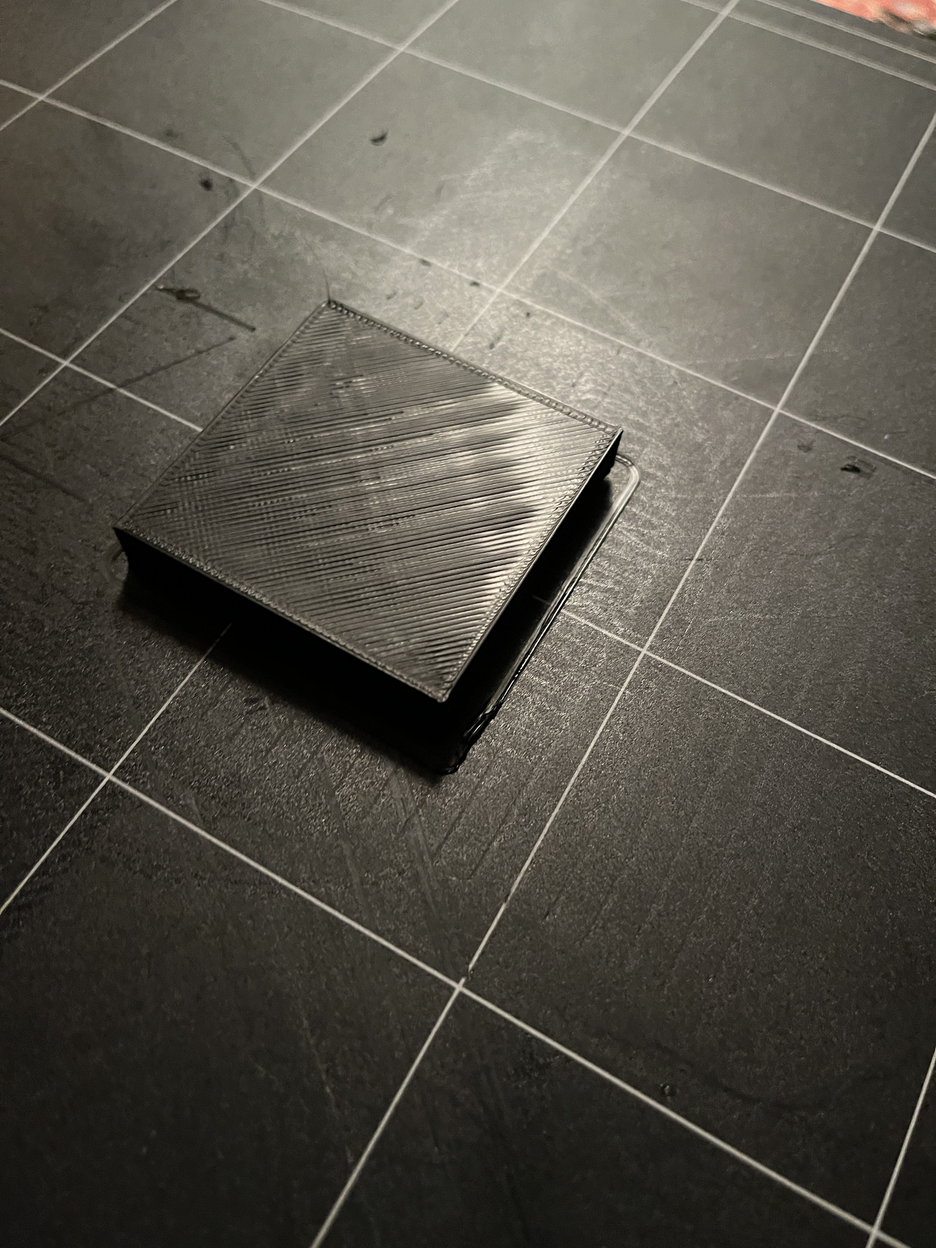

![image](https://us1.discourse-cdn.com/flex022/uploads/snapmaker/original/3X/8/8/8846b7cbc2de98131f0d60b43b0096b3ea0f4349.jpeg)
My prints keep coming out look like this (see attached)
I have been trying different settings like setting the infill to 100% and adjusting layer heights
They have made some what of a difference, but still the same “Swiss cheese” structure
I have tried turning the nozzle temperature up to 250 degrees and lowering the work speed to 75% which seem to have minimal effect too
Initially layer looks fine, but it’s the rest of the print that looks like this……
…please help
**Author:** ![Mxbrnr](https://sea2.discourse-cdn.com/flex022/user_avatar/forum.snapmaker.com/mxbrnr/32/27569_2.png) [@Mxbrnr](https://forum.snapmaker.com/u/Mxbrnr)\
**Post date:** [March 16, 2023, 4:48pm UTC](https://forum.snapmaker.com/t/please-help-i-don-t-understand-what-setting-i-need-to-adjust/30289/2 "2023-03-16T16:48:16Z")
What filament type is it?
Have you dried the filament?
What machine do you have?
Is the photo you shared showing the bottom layer or the top layer?
**Author:** ![IMMORTEN](https://avatars.discourse-cdn.com/v4/letter/i/a183cd/32.png) [@IMMORTEN](https://forum.snapmaker.com/u/IMMORTEN)\
**Post date:** [March 16, 2023, 4:54pm UTC](https://forum.snapmaker.com/t/please-help-i-don-t-understand-what-setting-i-need-to-adjust/30289/3 "2023-03-16T16:54:40Z")
Thank you for the reply…
Filament is black PLA…I have not done anything to the filament other than take it out of the box and load it into the printer
Machine / printer is a Snapmaker 350 all as it came from the factory, no aftermarket addons or modifications.
The photo is not showing the bottom layer, its showing the print from the top

**Post date:** [March 16, 2023, 8:13pm UTC](https://forum.snapmaker.com/t/please-help-i-don-t-understand-what-setting-i-need-to-adjust/30289/5 "2023-03-16T20:13:29Z")
250 is way too hot for PLA. Shouldn’t need to be anywhere above 250 and generally around 205.
What does the roll say on it?
Share a photo of your first layer so we can see how that’s going down.
Have you calibrated your extruder/e-steps? [Summary: Extruder calibration a must](https://forum.snapmaker.com/t/summary-extruder-calibration-a-must/16667)
**Post date:** [March 16, 2023, 8:27pm UTC](https://forum.snapmaker.com/t/please-help-i-don-t-understand-what-setting-i-need-to-adjust/30289/6 "2023-03-16T20:27:07Z")
I was just going to say the same as @sdj544. The photo of the top layer looks like the filament is MUCH too hot, causing it to collapse and ooze a lot. Most PLA is in the 190-200c range. I would first start by dehydrating the filament just to be sure there is no moisture in it. You can put it in your household oven at 135F for about 1hr and that should do it. Then I would try a print using all default settings and see how that comes out.
Can you share what your other slicer settings are? Specifically…
Layer Height
Print Speed
Bed Temp
And yes, more photos of the rest of the failed print for comparison would be helpful.
**Author:** ![clewis](https://sea2.discourse-cdn.com/flex022/user_avatar/forum.snapmaker.com/clewis/32/3255_2.png) [@clewis](https://forum.snapmaker.com/u/clewis)\
**Post date:** [March 16, 2023, 9:15pm UTC](https://forum.snapmaker.com/t/please-help-i-don-t-understand-what-setting-i-need-to-adjust/30289/7 "2023-03-16T21:15:11Z")
I don’t think your first layer is good either. There are some spots on the right that I can see through.
Too me, it looks both too hot and under extruded. And it looks consistently under extruded. In the upper left and lower right you can see through the top layer to lower layers, and the line width is fairly consistent in both layers.
**Post date:** [March 17, 2023, 4:32am UTC](https://forum.snapmaker.com/t/please-help-i-don-t-understand-what-setting-i-need-to-adjust/30289/8 "2023-03-17T04:32:52Z")
![image](https://us1.discourse-cdn.com/flex022/uploads/snapmaker/original/3X/a/8/a8e3d2bc9a2d74a7c930ff6dc6852b120ece06ad.jpeg)
Okay I have no idea what I did exactly, but after tweaking with the settings for pretty much whole day, I finally got some acceptable results.
Side note: it should not be this difficult to use, especially right out of the box and for a total newbie like me.
I even had to go in and enable advanced settings to get it to make these results.
It seriously should not be this difficult or complicated to get to print right.
Anyway; I’m going to start with my bigger projects now (which apparently takes 4 days to print) and see how they turn out.
Thank you for the help everyone
