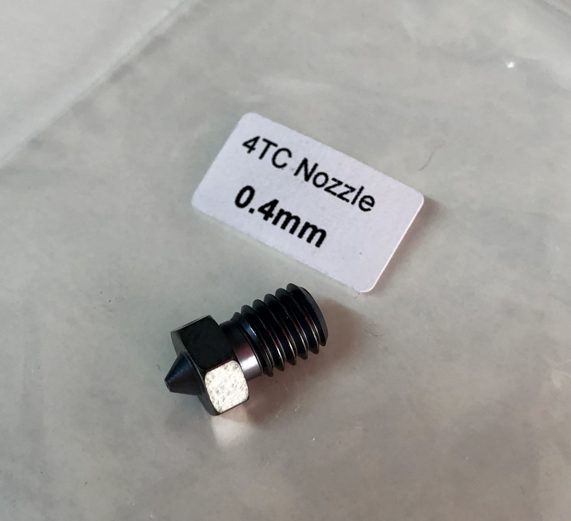

Picked up a V6 0.4mm Nozzle X from [e3d](https://e3d-online.com/products/v6-nozzles)
 ![IMG_0367](https://us1.discourse-cdn.com/flex022/uploads/snapmaker/original/2X/1/1fbd5bb3f23c34563d4d6fec057e8d514b3852c4.jpeg)
Fitting is pretty straightforward, although the existing nozzle is on pretty tight.
I found it easier to take off the thermal protector sleeve, then take out the top and bottom parts of the hotend, re-fit the sleeve then hand tighten both parts before a little tighten with a spanner.
 ![IMG_5987](https://us1.discourse-cdn.com/flex022/uploads/snapmaker/original/2X/9/9b24b5beb0ff993b0faaa8c0e93968b94ac31066.jpeg)
 ![IMG_9125](https://us1.discourse-cdn.com/flex022/uploads/snapmaker/original/2X/7/7782e45244e8c14fe2130bf59e7ca3c38dce0325.jpeg)
After installing I did the following:
1. Level the bed, I do this manually as I use glass. Be careful it doesn’t scrape the bed as it’s a bit longer (didn’t measure it) and I noticed in manual calibration it will move to point 1 already lowered. It doesn’t do this for subsequent calibration points.
2. Validate Extruder Calibration - [Guide](https://all3dp.com/2/extruder-calibration-6-easy-steps-2/)
3. Validate K-Factor - [Top Layer(s) not completed](https://forum.snapmaker.com/t/top-layer-s-not-completed/7240/17)
I found it worthwhile to increase the hotend temperate by 5C, I used 195C with stock and AMZD3D PLA. So 200 with the Nozzle X.
