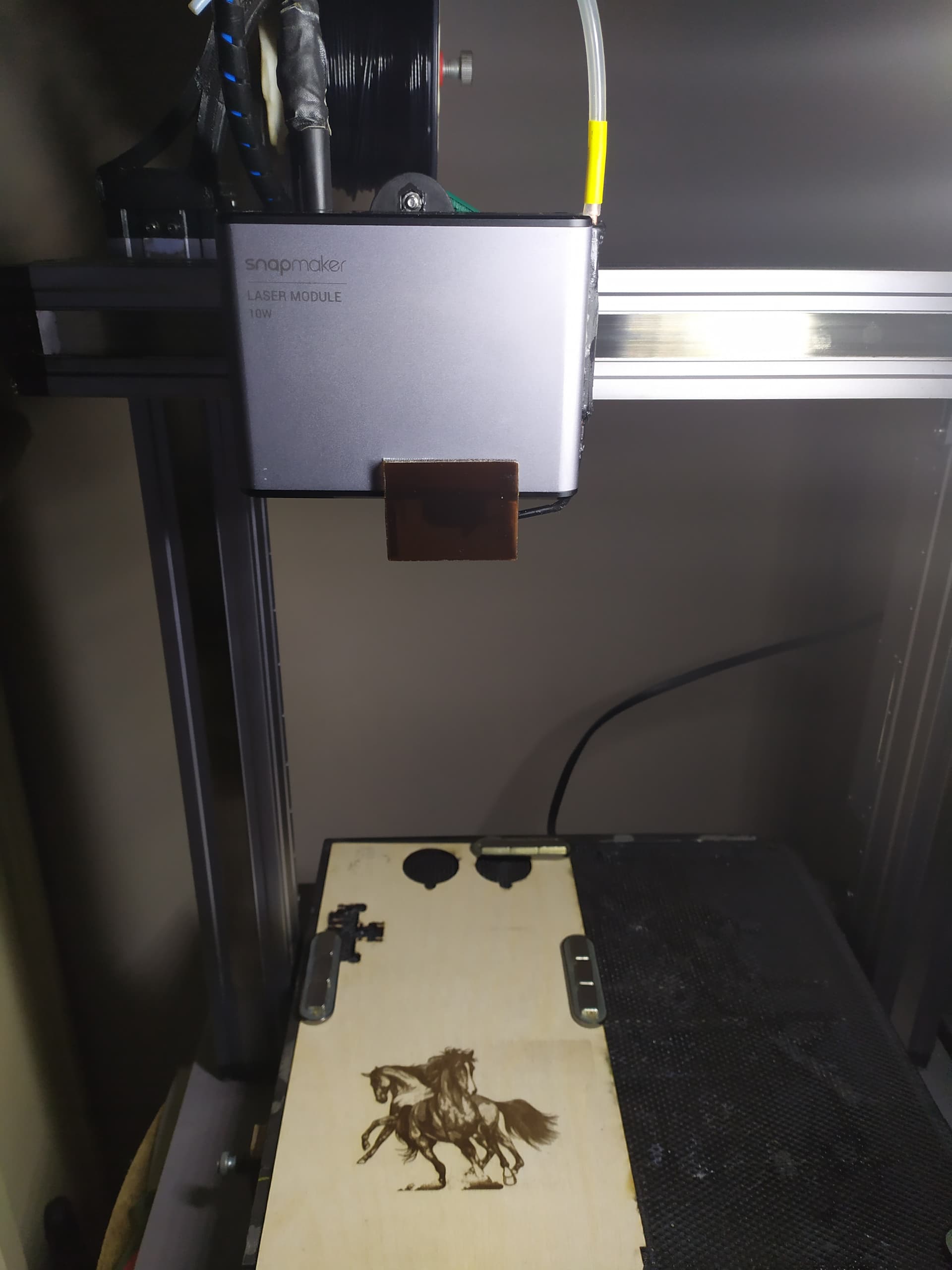

**Post date:** [February 13, 2022, 10:27pm UTC](https://forum.snapmaker.com/t/new-10w-laser-requires-the-enclosure/23705/28 "2022-02-13T22:27:13Z")
Uploading: IMG\_20220213\_225530.jpg…
 ![IMG_20220213_225530](https://us1.discourse-cdn.com/flex022/uploads/snapmaker/original/3X/d/6/d6ff3c7e68ecb41af33816647fa06b39ef4b533f.jpeg)
