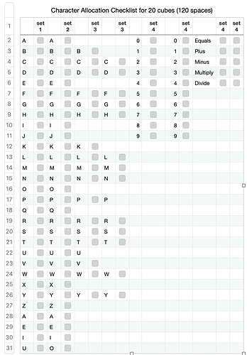

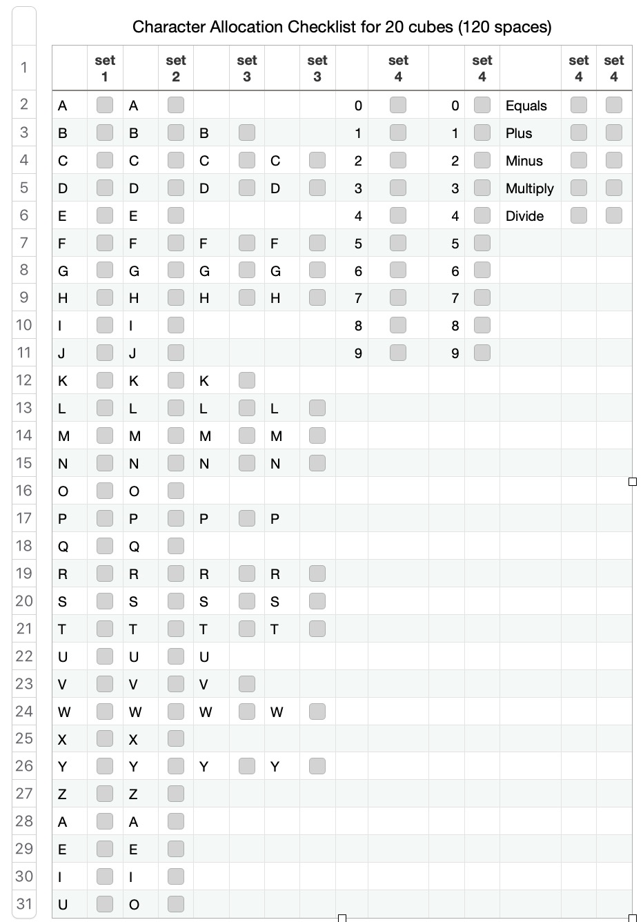

 ![Screenshot 2020-05-30 22.54.08](https://us1.discourse-cdn.com/flex022/uploads/snapmaker/original/2X/b/bb087f5629432d113cbfeb0353271fee7bc59ed0.jpeg)
The image shows the template of how I selected which characters to engrave on the blocks. I divided my 20 blocks into sets of five and then I used a checklist to show me which characters had been used and which remained to be engraved.

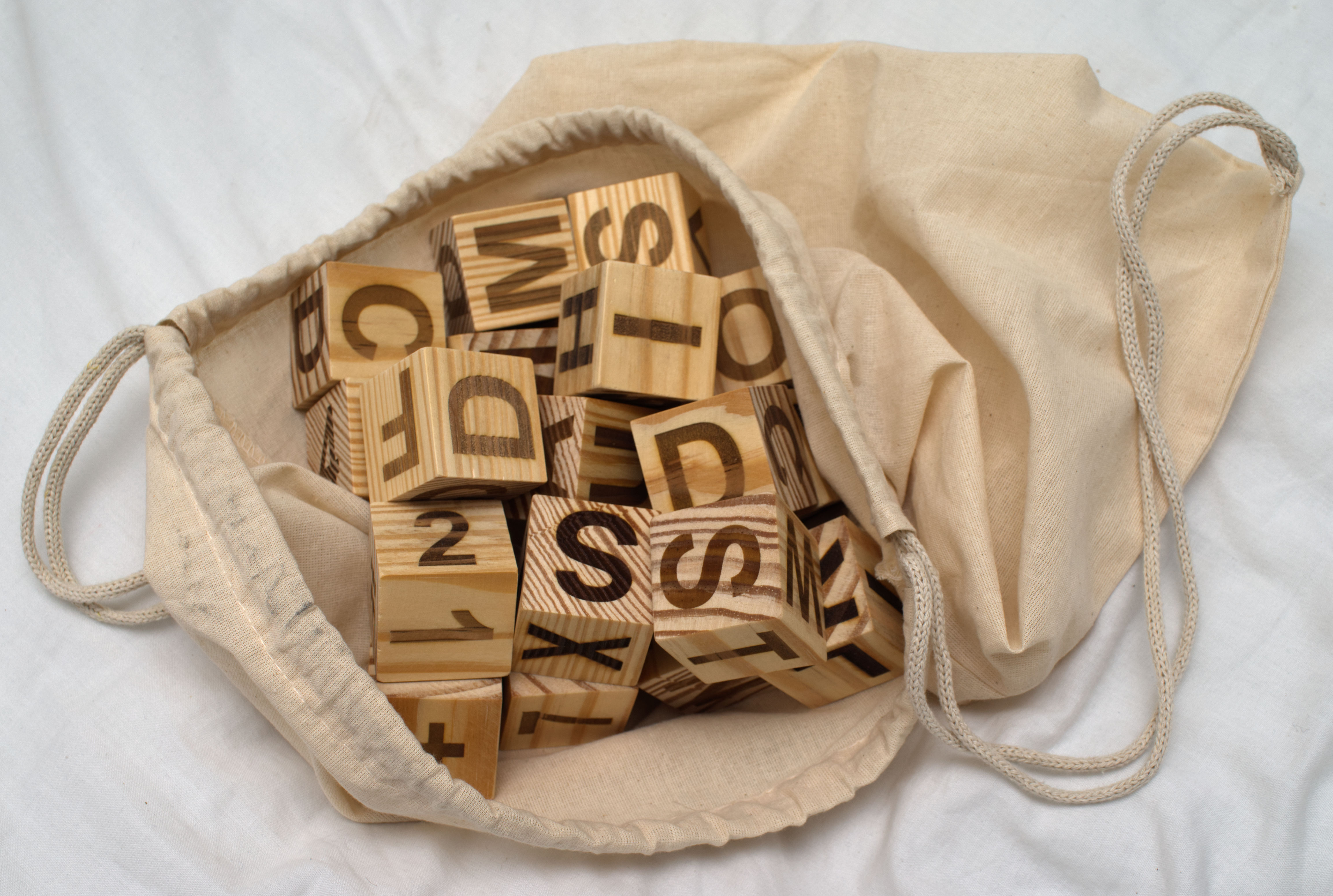

Next are some pictures of the project on the grounds that one picture is worth 1000 words…
 ![sack of bricks](https://us1.discourse-cdn.com/flex022/uploads/snapmaker/original/2X/5/543f2c65e965c913382be4f4ee449ec62c56a2e3.jpeg)
A sack of bricks. The sack is a cotton rucksack which should assist a child with storage and carrying the bricks.

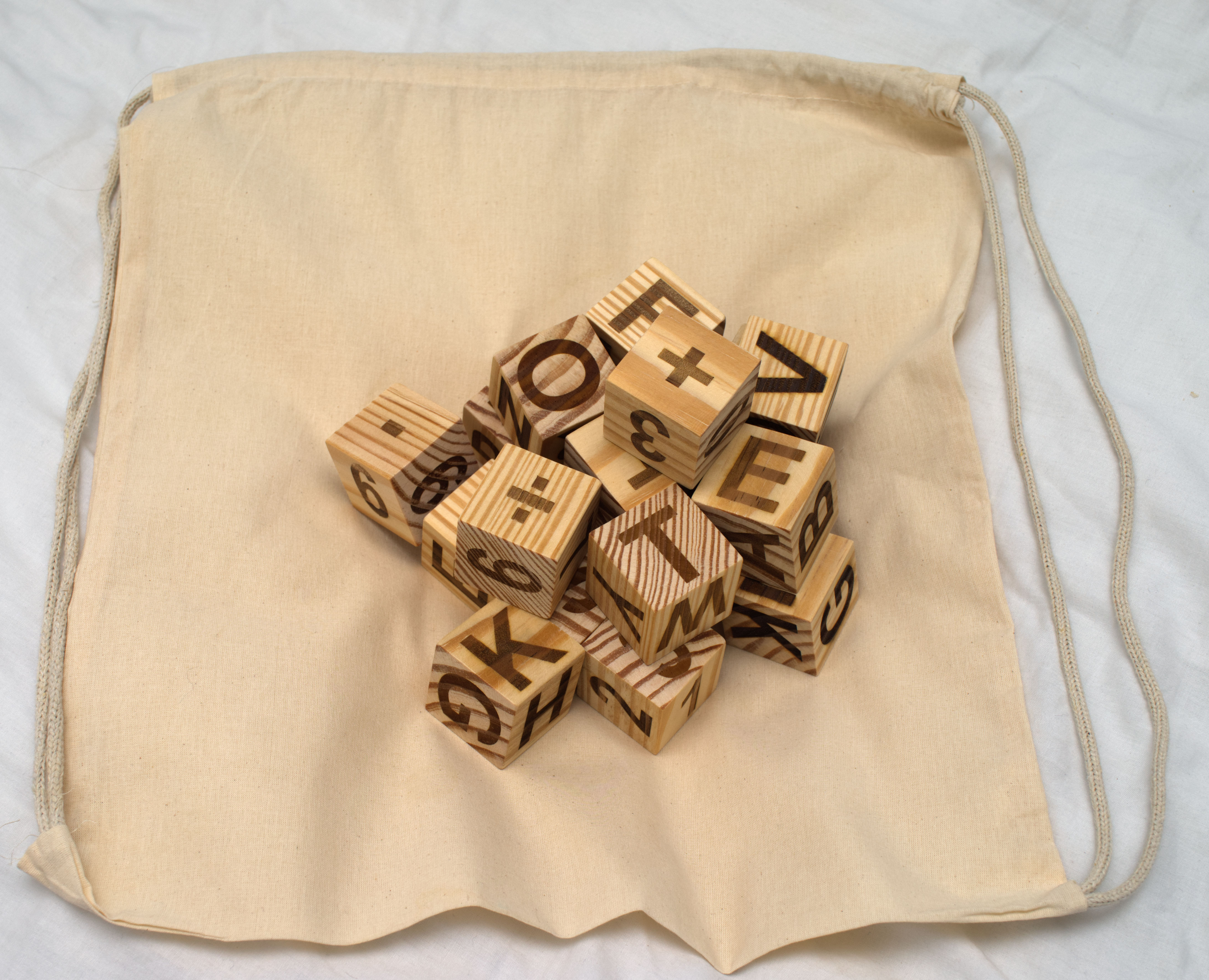

 ![bricks and rucksack](https://us1.discourse-cdn.com/flex022/uploads/snapmaker/original/2X/b/b9799f702e81a850a60cafd10fb07e103aee2b2d.jpeg)
The bricks sitting on the rucksack in the sort of image that may promotes sales.

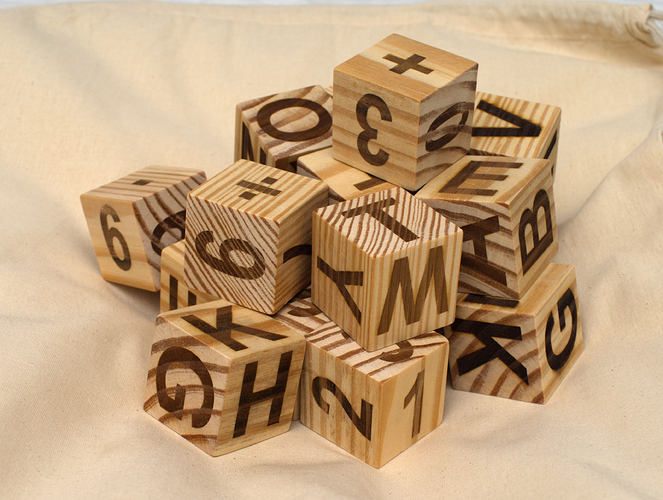

 ![pile of bricks](https://us1.discourse-cdn.com/flex022/uploads/snapmaker/original/2X/a/a665aeca35b31d4e23728aa07421c88cabad7df3.jpeg)
Close up shot of a pile of bricks to make them look more desirable.

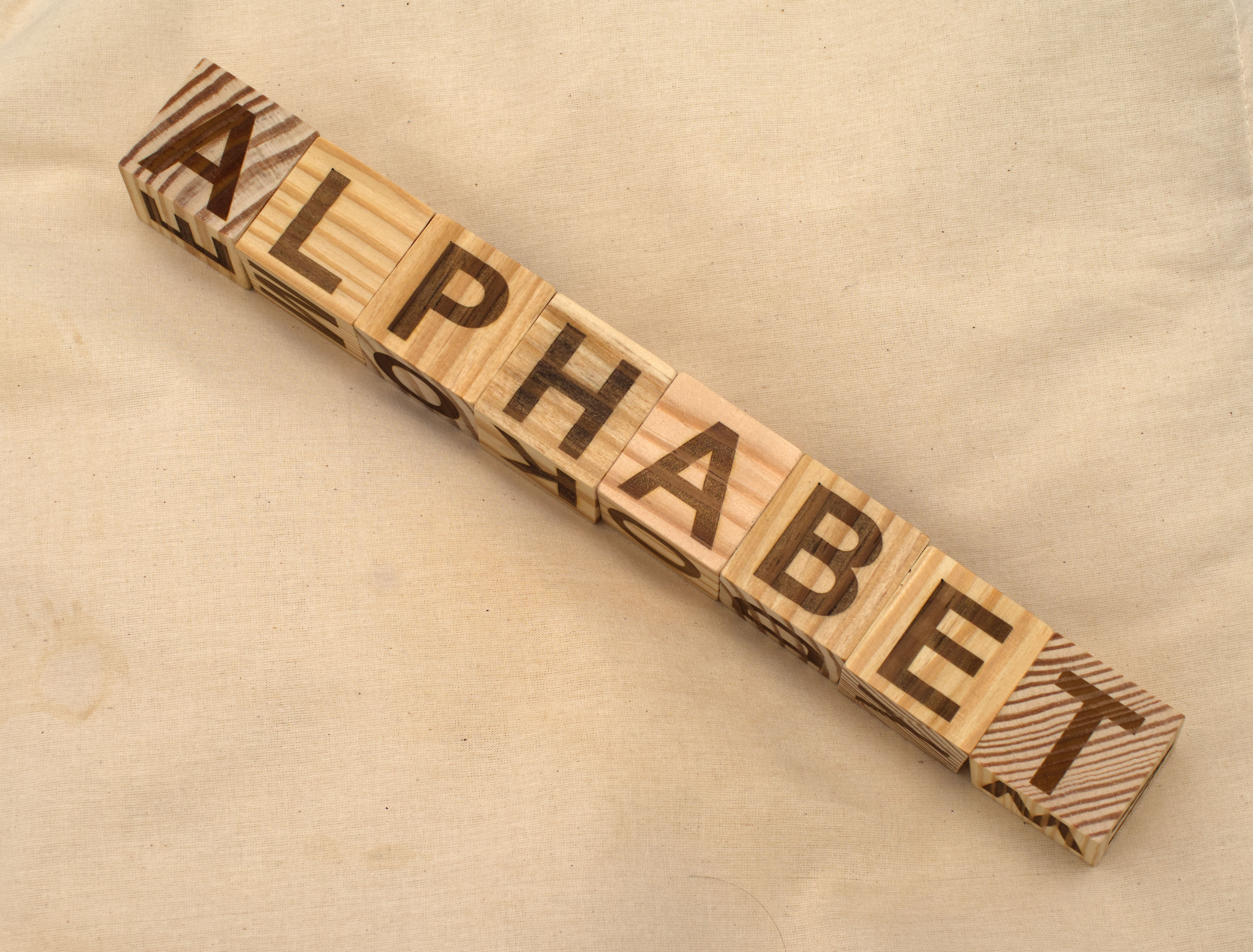

 ![alphabet](https://us1.discourse-cdn.com/flex022/uploads/snapmaker/original/2X/b/b1abd87652ac190d1fa6b232aafccac2ba084c77.jpeg)
Demonstrating that there are enough letters to spell words

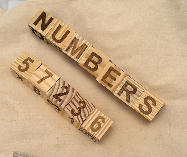

 ![numbers](https://us1.discourse-cdn.com/flex022/uploads/snapmaker/original/2X/a/a153127363b92b4342fc042909ed7988d8745935.jpeg)
Showing how the numbers appear in the set.
