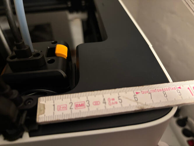

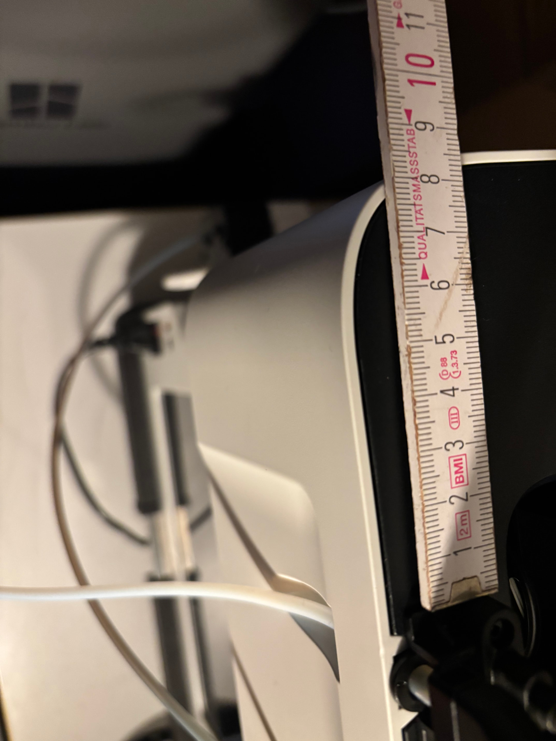

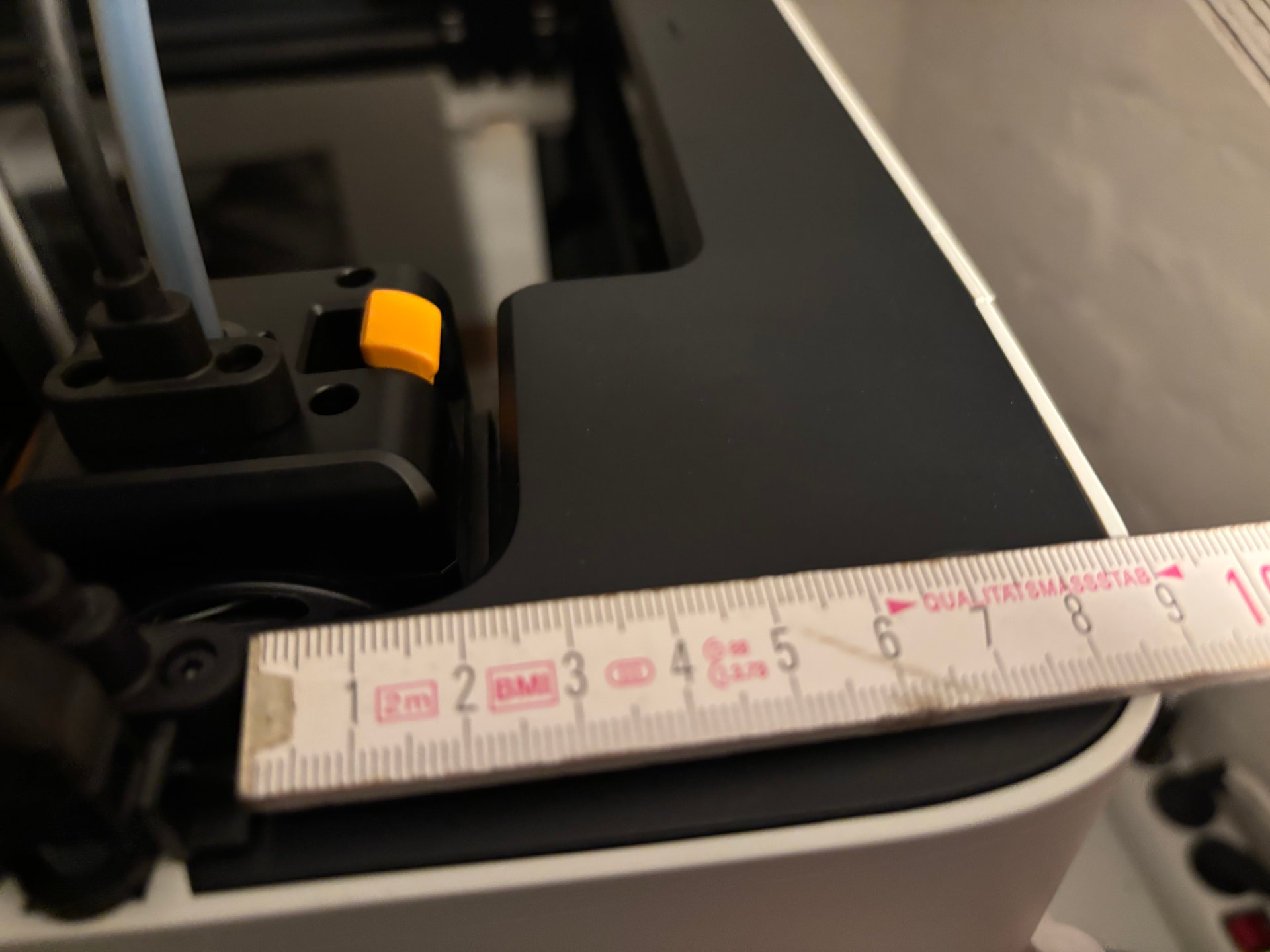

Hi, I’m currently developing an add-on for the Snapmaker U1, and during my measurements I found two different distances between the cable guide and the machine housing. Before I continue designing, I’d like to check whether this is a measurement consistency or if the units vary.
If you own a U1, could you please measure the distance between the cable guide and the housing on your machine and let me know what you get?
Any input would really help clarify whether there are tolerances or egularities.
My values are 9 to the right and 8.5 to the left, pictures added..
Thanks in advance!

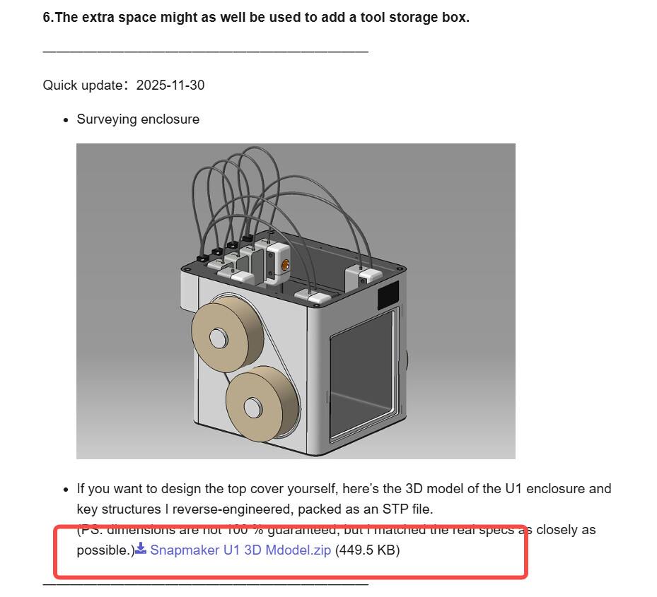

Maybe it’s more convenient for you to use my 3D model directly.
[U1 Top-Cover Mod （ING） - U1 Toolchanger - Snapmaker: where creation happens](https://forum.snapmaker.com/t/u1-top-cover-mod-ing/40421/18)

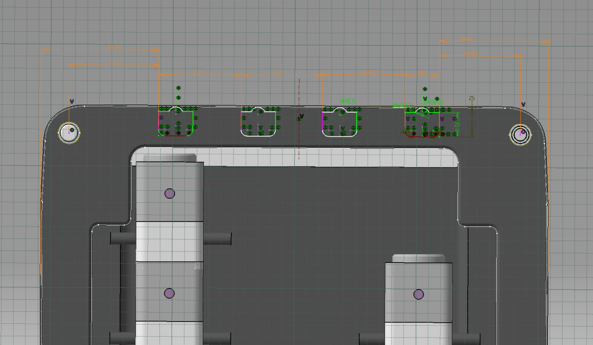

Hi, thank you very much, this is awesome.. My Problem still is: Your Model is perfectly symetrical, while mine IRL is not. And i cant see any part, like the outer plastic that is misaligned or something.. Did you measure your device exactly left and right? I made a sketch of the measurements i did before in Fusion.. My device has 8,5cm on the right and 9cm on the left..

Perfect, thank you, bought the scan an it pretty much matches my measurements, so the device is not exactly symmetrical in this region. Thats what i needed to know!

I finally found that you were right, the left and right are not symmetrical. I recalibrated the model. Here are my calibrated parameters.

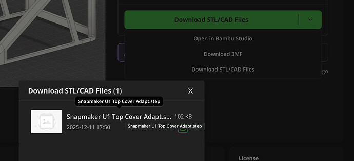

**Post date:** [December 11, 2025, 11:23am UTC](https://forum.snapmaker.com/t/measurements-u1/40625/11 "2025-12-11T11:23:56Z")
[https://makerworld.com/models/2103113-snapmaker-u1-top-cover-adapt#profileId-2274470](https://makerworld.com/models/2103113-snapmaker-u1-top-cover-adapt#profileId-2274470)
