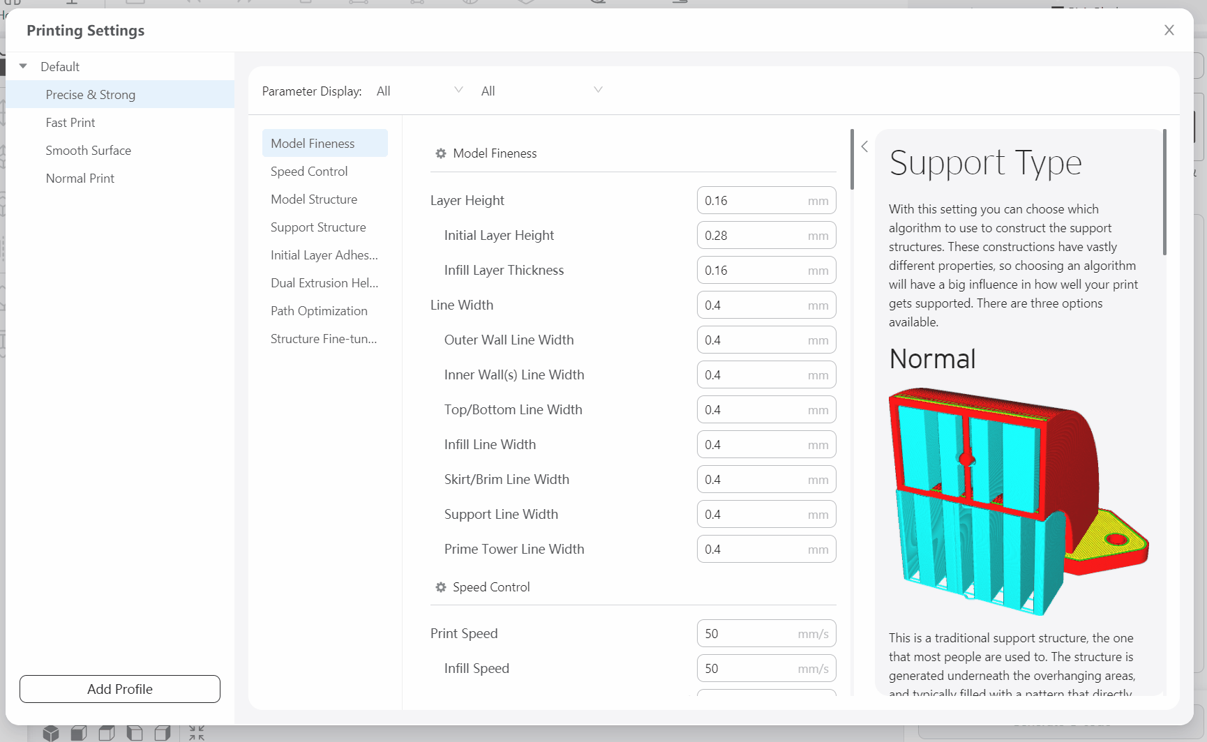

#### Configuration parameters
- 290+ material parameters and print parameters(more advanced parameter)
  - Speed control: Fine structure speed control, acceleration control, jerk control
  - Support: Multi-density support, tree support, support preference
  - Fill: Fractal fill, multi-density fill
  - Top and bottom: Ironing mode
  - Structure fine-tuning, path optimization
- New quick parameter setting interface, while also retaining the old version of the custom display parameters
- Enhanced parameter management interface
  - Variety of parameter display modes
  - Detailed parameter explanation

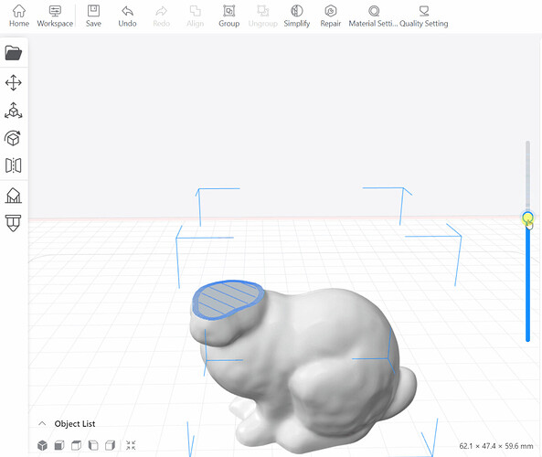

#### Simulation Preview
- Enhance the original thin line preview to a simulation preview with a volume, which has better visual effects and is more in line with the printed product (but it will have higher performance, especially the Gcode of large models has certain memory requirements)
 ![image](https://us1.discourse-cdn.com/flex022/uploads/snapmaker/original/3X/0/3/03a351cfd6a0f77bb552a550da0695daa713cd94.jpeg)

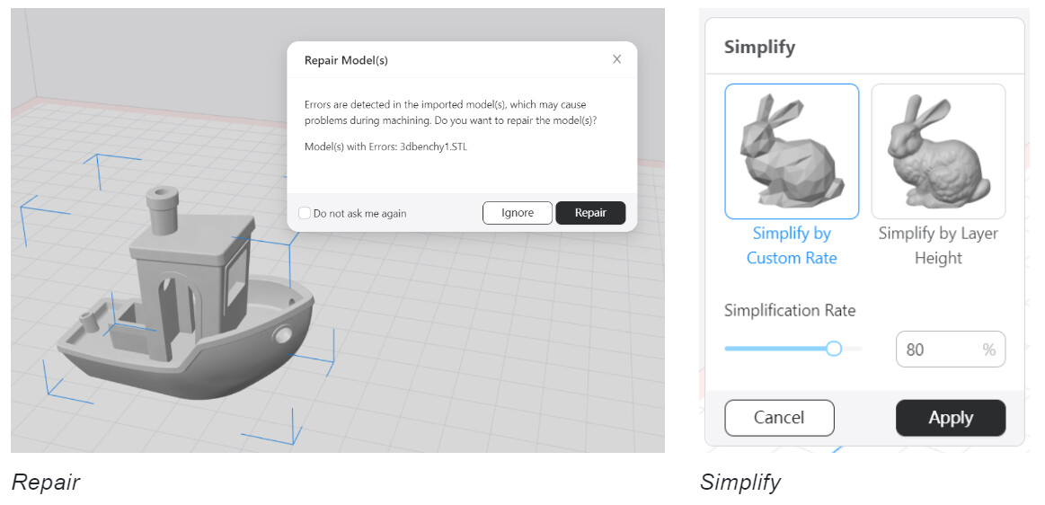

#### Model Repair and Model Simplification
- Added model repair function to fix common error
- Added model simplification to streamline the model or convert the model to a low-poly style under the limits of print accuracy
 ![image](https://us1.discourse-cdn.com/flex022/uploads/snapmaker/original/3X/2/8/28ebf41bbbc98b4ba23cedb16609843c9d4e257b.jpeg)

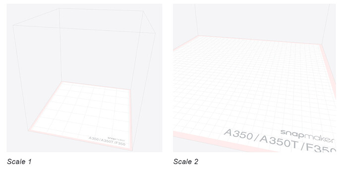

#### 3D Canvas Style Updates
- Updated the display style to make the overall more coordinated
- Added dynamic display of plate scales at different scales
- Optimized zoom interaction and panning after zooming in

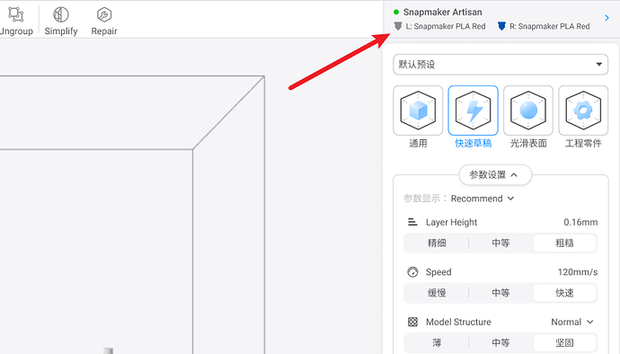

Feedback: I tried duel extruder to see how it would work, mostly painless, but some dialogs (material choice) forgot or did not respect my machine settings. I changed the material dialog over to machine/material settings and selected the Not Ready dual extruder there too, then I could edit the second material. Applying materials to a model seems easy enough, and I like the option to use different material for infill/walls of the model, along with options for all supports etc. I would love to be able to paint areas of the model with a material like the supports can be custom selected / painted onto the model using Edit. Imagine painting the eyes of a frog.

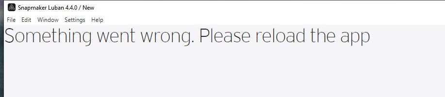

I installed v4.4.0 and had problems setting the bed temperature, whatever I did the gcode file had the temp set at 70C. I played around editing material settings and eventually broke Luban. Uninstalling and reinstalling does not fix the issue, I expect there is a persistent file somewhere which has become corrupted. Screenshot:
 ![Screenshot 2022-09-15 012450](https://us1.discourse-cdn.com/flex022/uploads/snapmaker/original/3X/c/7/c720d29eff682060b26cd9f494f04d314f93dcd9.jpeg)
This happens just after the 3D print screen appears, I think while its loading the materials library.
Laser and CNC workspaces do not crash the app.

We have updated with a new package. If you still have problems, you can consider applying Alt+Shift+R on the home page to restore the original installation state
**Author:** ![albutch](https://sea2.discourse-cdn.com/flex022/user_avatar/forum.snapmaker.com/albutch/32/16397_2.png) [@albutch](https://forum.snapmaker.com/u/albutch)\
**Post date:** [September 16, 2022, 4:02pm UTC](https://forum.snapmaker.com/t/luban-v4-4-0-beta-test/27218/7 "2022-09-16T16:02:40Z")
Thanks, appears to be OK now.
