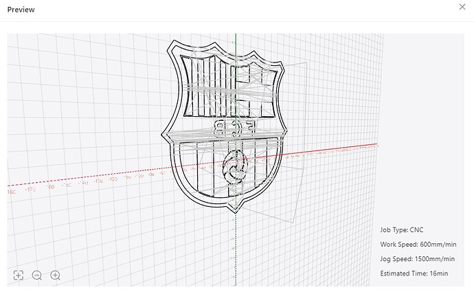

**Post date:** [December 12, 2025, 4:01pm UTC](https://forum.snapmaker.com/t/luban-cnc-dont-show-transparent-image/38576/10 "2025-12-12T16:01:23Z")
Hello everyone,
Not to open a new topic.
The CNC has a strange way of working, for example I took the logo of Barcelona and when I start milling, the CNC works on one part of the image, then on the other, strangely all the way, because I tested this the other day and it worked beautifully. In addition to working properly, there were not so many of these lines. I guess these lines are traveling lines, where the head moves…
Also, in addition to setting the stepover, work speed, selected tool and material… there is no way to reduce the milling time, and I managed to 11 min, now the minimum is 32…
I don’t understand, this Luban is disastrous.
 ![cnc](https://us1.discourse-cdn.com/flex022/uploads/snapmaker/original/3X/b/0/b0857878b7af44822331b6158727c7168cc68d95.jpeg)
**Author:** ![Davor](https://avatars.discourse-cdn.com/v4/letter/d/3d9bf3/32.png) [@Davor](https://forum.snapmaker.com/u/Davor)\
**Post date:** [December 12, 2025, 4:04pm UTC](https://forum.snapmaker.com/t/luban-cnc-dont-show-transparent-image/38576/11 "2025-12-12T16:04:53Z")
After reinstalling Luban, much better situation….
 ![rrrrr](https://us1.discourse-cdn.com/flex022/uploads/snapmaker/original/3X/1/9/19e3abbfcc8660e0415fdf454a7e3fbffe70d361.jpeg)
