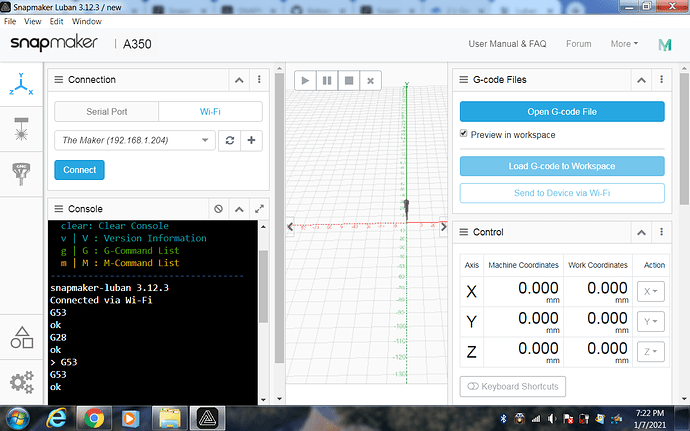

Luban refuses to load or even show a load botton for 3D printing. I can load cnc and laser objects but even the featured vase from snapmaker won’t load. Here is a screenshot without the fourth button on the left side. Even in the HTML code it doesn’t load the lines for the button. I’ve spent literally hours trying older versions of luban, reconnecting the printer, and searching everywhere. I can’t find anyone with the same problem.

Do you have the 3D Printhead conectet?

Yes and it runs the home position no problem. Here’s another shot:

There is the 3D button missing as you said, I have no Idea why, dont use Luban.

No I didn’t try usb, that might work. I ended up switching to a different computer and that fixed it. I’m running windows 7 on my laptop and that might have been the problem 🤷‍♂️ Thank you so much for the quick help! I really appreciate it! I hope you have a wonderful day/night friend!!

Hi @3ddud3 @Frydai1958 I am not sure if you are using the 32-bit Luban software. The 32-bit Luban software does not support the 3D printing slicer and it is missing there. If you are using the 32-bit system, so that is the problem.
