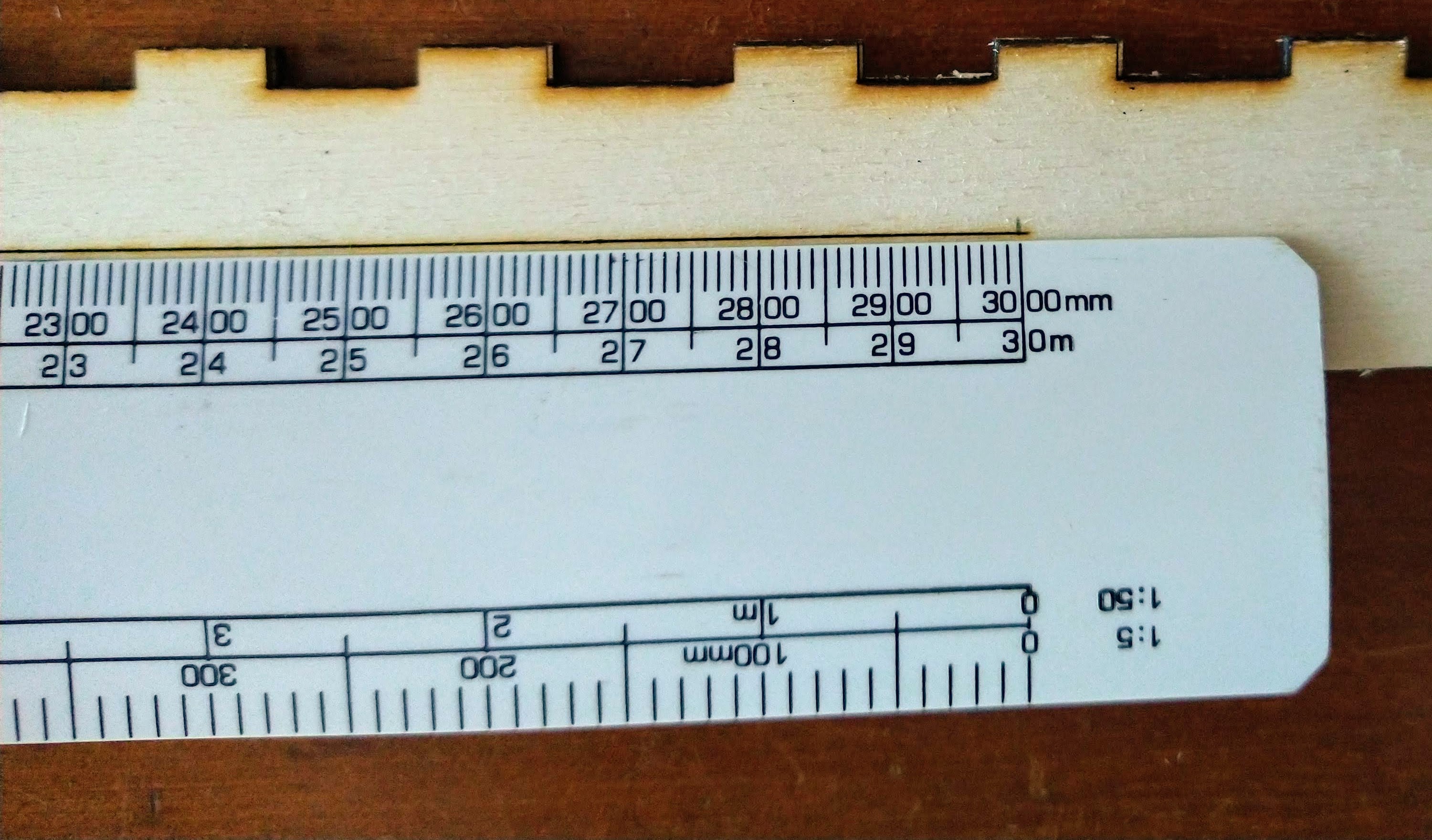

I think that some of the several problems being reported in this and other forums are caused by the same issue: **the non-uniform lineal modules working speeds.** I will try to summarise in one post my experience and how I have “solved” (or better said, hacked) the problem.
First of all a bit of background: I ordered my SM 350A in July 2019 (as part of the pre-sales batch) and received it in mid September 2020. I am using Luban 3.9 with the firmware version 1.9.0 .
Since the beginning I have been experiencing the infamous “Bump” in the Y-axis (more info here: ["Bump" in Y-axis](https://forum.snapmaker.com/t/bump-in-y-axis/10017)). Several tests after, I proved that the two linear modules of that axis weren’t moving at the same speed. I guess that one of the lineal modules drags the other forcing it to jump a step (or something similar), which causes both the noise and the displacement of the bed in the Y-axis. Thus, when attempting to cut 3mm plywood pieces, the laser doesn’t go through the same path in each pass, making it impossible to be cut.

The straightforward solution to this problem consist on finding a couple of lineal modules that move at the same speed and installing them in the Y-axis (and another couple in the Z-axis). This was easy for me, as I found that the X-axis one moved at the same speed as one of the modules of the Y-axis.
After changing it, the “bump” disappeared and I was able to cut large 3mm plywood pieces without problems (in more than 4 passes however, but I believe that is another issue related with the non-horizontality of the bed and with the laser becoming quickly out of focus once it moves away from the place it was calibrated. It was a problem with the focus length).
However, I observed that one of the pieces that I cut, that should be 304mm long in the Y-axis, was instead 305mm. This could not be an issue in most cases, but again is another effect of these non-uniform lineal modules working speeds.
To check this I drew two lines: one of 300mm along the Y-axis and another one of 250mm along the X-axis and measure then;
 ![IMG_20201020_132337317](https://us1.discourse-cdn.com/flex022/uploads/snapmaker/original/2X/1/17e95fddeb9741a38707a409e40f1b5bbd283a18.jpeg)
 ![IMG_20201020_132300634](https://us1.discourse-cdn.com/flex022/uploads/snapmaker/original/2X/0/0efcab2ed1ca6537084fc2525e861c4a0815be9e.jpeg)
With a gauge I measured respectively a difference of +0.8mm and -0.3mm in each axis. The solution I have implemented here is to resize my drawings by a factor of: 300/300.8 in the Y-axis and 250/249.7 in the X-axis when editing them in Luban (this is, being my original drawing’s size of 290x340mm, I entered the values 290.3x339.1, so that the real cuts come out correctly sized)
It has worked, but this is more a hack than a solution.
I strongly believe that SM should change the way the lineal-modules are controlled. It looks like they have implemented an open loop (this is, knowing that the lineal modules move at a speed of Xmm/step, if it needs to be moved 1mm, 1/X steps are made) instead of a close one (in which the position of the lineal modules are corrected in case the speeds are not the theoretical one, which is the case).
Another good solution could be a way to calibrate these speeds, so that the Snapmaker could adjust their working speeds to correct these little deviations.

I don’t have my SnapMaker yet, so I’m not sure if this is possible, but I know on my Ender 3 that I can manually calibrate the xstep and ystep values (default is 80/mm for my printer). I’m wondering if it’s possible to do this on the SnapMaker to adjust for the differences rather than having to resize your drawings in Luban? Maybe it’s a manual gcode thing you’d need to send to the printer? Someone more experienced than me is welcome to chime in here!
### Author: ![Atom](https://sea2.discourse-cdn.com/flex022/user_avatar/forum.snapmaker.com/atom/32/5608_2.png) [@Atom](https://forum.snapmaker.com/u/Atom)
#### Post date: [October 30, 2020, 1:06am UTC](https://forum.snapmaker.com/t/lineal-modules-non-uniform-working-speed/10715/4 "2020-10-30T01:06:26Z")
You can adjust the steps per mm on any marlin based device. But that will only work in places where you are only using 1 rail for the axis. So for instance if you have the a350 with 2 y rails, and they are not moving at the same rate. Then any adjustment would be done to both and they would still not move at the same rate. Does that make sense?
### Author: ![gilahacker](https://avatars.discourse-cdn.com/v4/letter/g/e19adc/32.png) [@gilahacker](https://forum.snapmaker.com/u/gilahacker)
#### Post date: [October 30, 2020, 1:41am UTC](https://forum.snapmaker.com/t/lineal-modules-non-uniform-working-speed/10715/5 "2020-10-30T01:41:44Z")
Yes it does make sense. I think I read somewhere that it’s because SnapMaker uses a Y-cable to run both of the Y-axis linear rails off the same signal instead of them being independent, correct? (you might even have been the one I read that from, as I’ve been following your… adventure).
My understanding is that the OP moved around their rails so that they now have two Y-axis ones that are in sync. Based on that I’d assume stepper motor calibration should work if it’s an option on the SnapMaker. You mentioned Marlin, but I don’t know if SnapMaker’s firmware is Marlin-based or something else. I’m sure it’s been mentioned somewhere, I just don’t remember.
#### Post date: [October 30, 2020, 1:49am UTC](https://forum.snapmaker.com/t/lineal-modules-non-uniform-working-speed/10715/6 "2020-10-30T01:49:30Z")
Yes you are correct and for the record most 3d printers use 1 output for all the motors running that axis. Also you are correct about the calibration working as long as both rails move the same distance.
Lastly the SM2 is a hodgepodge of things, it uses Android for its wifi and user interface, it has some sort of main mcu that can inturprate the CAN signals but at its core it is Marlin based. It is that base that allows us to run the Marlin flavor of Gcode (that luban, and cura and other programs output) there are other options out there such as GRBL but almost all hobby machines run on Marlin.
